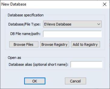

Creating a Database
To create a database, simply select File/New/Database… from the main menu.
For a native EViews database, simply enter a name for the database in the field labeled DB File name/path, then click on the button marked OK. This will create a new EViews database in the current path.
To create a database in a different directory, you can enter the full path and database name in the DB File name/path edit field. Alternatively, you can browse to the desired directory. Simply click on the Browse Files button to call up the common file dialog, and then navigate to the target directory. Enter the name of the new database in the File name edit field, then click on the OK button to accept the information and close the file dialog. EViews will put the new path and filename in the DB File name/path edit field.
The Database/File Type field allows you to create different types of databases. See “Foreign Format Databases” for a discussion of working with different database types.
The Open As field allows you to specify the shorthand that will be associated with this database. A shorthand is a short text label which is used to refer to the database in commands and programs. If you leave this field blank, a default shorthand will be assigned automatically (see “Database Shorthands”).
The Browse Registry and Add to Registry buttons provide a convenient way to recall information associated with a previously registered database or to include the new database in the database registry (see “The Database Registry”).
A database can also be created from the command line or in a program using the command:
dbcreate db_name
where db_name is the name of the database using the same rules given above.

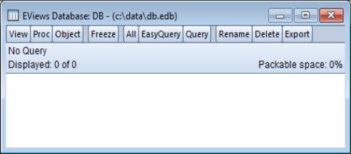

The Database Window
When you create a new database, a database window will open on the screen.
The database window provides a graphical interface which allows you to query the database, copy-and-paste objects to and from your workfile, and perform basic maintenance on the database. Note that some database operations can also be carried out directly without first opening the database window.
To open a database window for an existing database, select File/Open/Database… from the main menu. The same dialog will appear as was used during database creation. To open an EViews database, use the Browse Files button to select a file using the common file dialog, then click on OK to open the file. A new window should appear representing the open database.
From the command line or in a program, you can open a database window by typing:
dbopen db_name
Unlike a workfile window, a database window does not display the contents of the database when it is first opened, although it does tell you how many objects are in the database. The second line of the window text shows the number of objects currently displayed (zero when the window is first opened) followed by the total number of objects stored in the database.

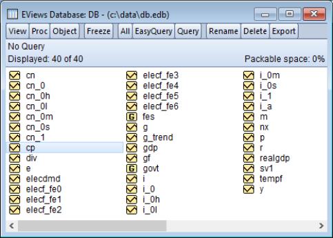

You can bring up an alphabetical listing of every object in the database by clicking on the All button:
As for a workfile, each object is preceded by a small icon that identifies the type of the object. When performing an All query, no other information about the object is visible. However, by double clicking on an object you can bring up a description of the object including its name, type, modification date, frequency, start and end date (for series), update and write times, metadata, and a preview of the data and a graph (if available).
For large databases, the All button generally displays too many objects and not enough information about each object. The database query features ( “Querying the Database”) allow you to control precisely which objects should be displayed, and what information about each object should be visible. The text form of the query currently being displayed is always visible in the top line of the database window.
When working with foreign databases, the object names may appear in color to indicate that they are illegal names or that an alias has been attached to an object name (see “Object Aliases and Illegal Names”).
The “Packable space” field in the database window displays the percentage of unused space in the database that can be recovered by a database pack operation (see “Packing the Database”).
