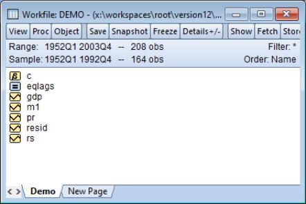

Note that EViews has automatically adjusted the estimation sample to accommodate the additional lagged variables. We will save this equation in the workfile for later use. Press the button in the toolbar and name the equation EQLAGS.
The EQLAGS equation object will be placed in the workfile.
