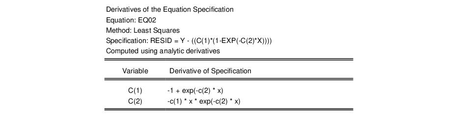

For example, consider the simple nonlinear regression model:
| (59.27) |
Following estimation of this single equation, we can display the description view by selecting
There are three parts to the output from this view. First, the line labeled “Specification:” describes the equation specification that we are estimating. You will note that we have written the specification in terms of the implied residual from our specification.
The next line describes the method used to compute the derivatives used in estimation. Here, EViews reports that the derivatives were computed analytically.
Lastly, the bottom portion of the table displays the expressions for the derivatives of the regression function with respect to each coefficient. Note that the derivatives are in terms of the implied residual so that the signs of the expressions have been adjusted accordingly.

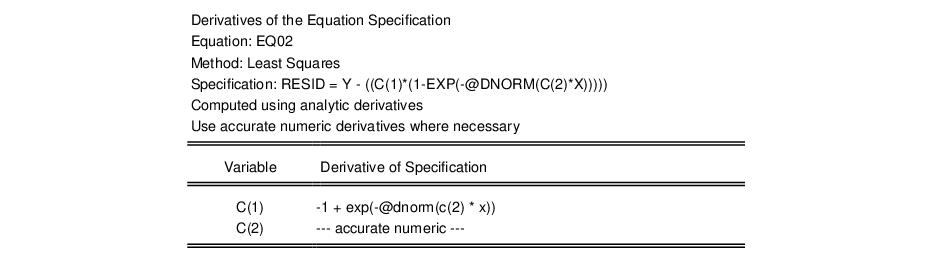

Suppose, for example, that we estimate:
| (59.28) |
where
is the standard normal density function. The derivative view of this equation is
Here, EViews reports that it attempted to use analytic derivatives, but that it was forced to use a numeric derivative for C(2) (since it has not yet been taught the derivative of the @dnorm function).

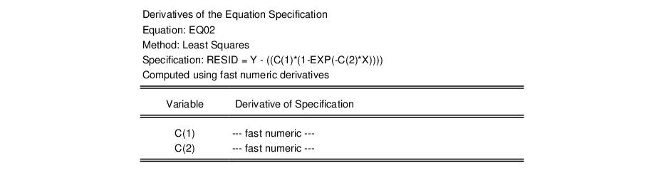

If we set the estimation option so that we only compute fast numeric derivatives, the view would change to
to reflect the different method of taking derivatives.

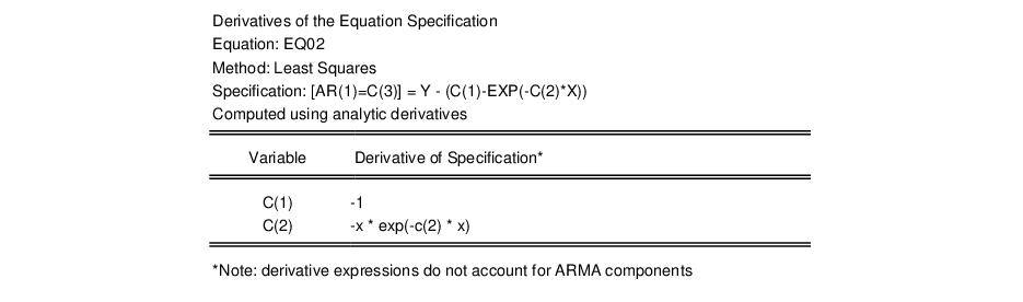

If your specification contains autoregressive terms, EViews will only compute the derivatives with respect to the regression part of the equation. The presence of the AR components is, however, noted in the description view.
Recall that the derivatives of the objective function with respect to the AR components are always computed analytically using the derivatives of the regression specification, and the lags of these values.

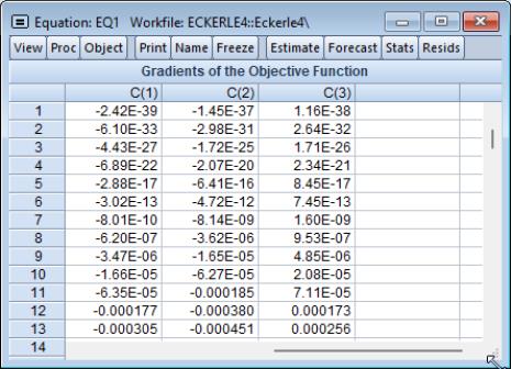

Once we obtain estimates of the parameters of our nonlinear regression model, we can examine the values of the derivatives at the estimated parameter values. Simply select to see a spreadsheet view or line graph of the values of the derivatives for each coefficient:
This spreadsheet view displays the value of the derivatives for each observation in the standard spreadsheet form. The graph view, plots the value of each of these derivatives for each coefficient.
