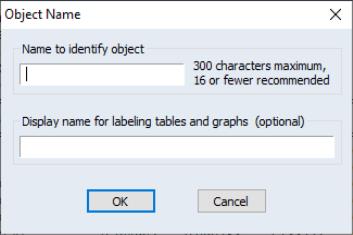

To rename an object, first open the object window by double clicking on its icon, or by clicking on on the workfile toolbar, and entering the object name. Next, click on the button on the object window, and enter the name (up to 300 characters), and optionally, a display name to be used when labeling the object in tables and graphs. If no display name is provided, EViews will use the object name. Note: before EViews 13, the maximum object name length was 24 characters. You may not be able to correctly open a workfile with object names longer than 24 characters in previous versions of EViews.
You can also rename an object from the workfile window by selecting and then specifying the new object name. This method saves you from first having to open the object.

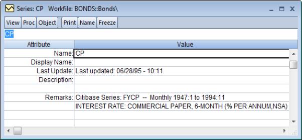

In addition to the display name described above, EViews objects have label fields where you can provide extended annotation and commentary. To view these fields, select from the object window:
This is the label view of an unmodified object. By default, every time you modify the object, EViews automatically appends the modification in the field.
You can edit any of the fields, except . Simply click in the cell that you want to edit. All attributes contain only one line, except the field, which can contain multiple lines. Press ENTER after entering data into the current field to add a new line to this attribute.

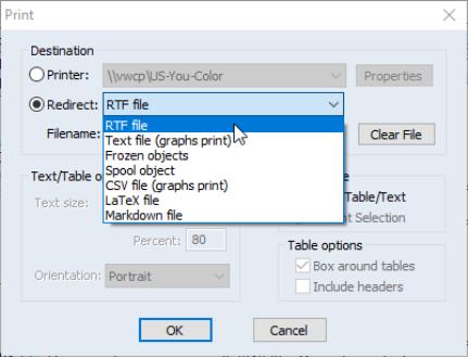

EViews will open a dialog containing the default print settings for the type of output you are printing. Here, we see the dialog for printing text information; the dialog for printing from a graph will differ slightly.
The default settings for printer type, output redirection, orientation, and text size may be set in the dialog (see
“Print Setup”) or they may be overridden in the current print dialog.
For example, the print commands normally send a view or procedure output to the current Windows printer. You may specify instead that the output should be saved in the workfile as a table or graph, spooled to an RTF or ASCII text file on disk, sent to a spool object, CSV file, LaTex file or Markdown file. Simply click on , then select the output type from the list.
The “(graphs print)” in the entries indicates that graphs will still be sent to the printer since the specified redirect type does not support graph output.
