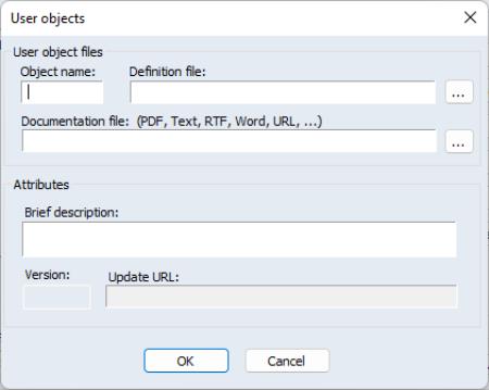

To register a new user object class, select Add-ins/Manage User Objects... from the main EViews menu to display the User objects management dialog, then click on the Add button to display the Add/Edit Program dialog.
The dialog allows you to provide a name for the user object class, to specify the INI file, attach a documentation file, and provide various object attributes:
The Object name edit field should be used to specify the user object class name. Note that if you provide the name of a built-in EViews object, the EViews built-in object will take precedence.
The Definition file edit field must be used to enter the name and path of the INI definition file. Note you may press the “...” button to navigate to and select the file.
The Documentation file edit field allows you specify a PDF, Text, RTF, Microsoft Word file, or URL containing documentation for the user object class. (Note that relative paths are evaluated with respect to the directory of the INI file, not the default user object directory.)
You may use the Brief description edit field to describe the purpose of the User Object.
You may enter a Version number for your user object and an Update URL indicating where to find the update XML file (see “XML File Specification”).
You must provide an object name and a definition file to register your object. The remaining information is recommended, but not required.
