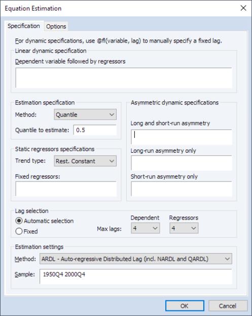

From the main EViews menu, click on Quick/Estimate Equation… or type the command equation in the command line to open the equation dialog. Then select the ARDL - Autoregressive Distributed Lag Models (including NARDL) from the Method dropdown to display the Specification tab of the ARDL dialog:
• In the first edit field under Linear dynamic specification, you should a enter a list of variables consisting of the dependent variable followed by any symmetric ARDL distributed lag regressors. At a minimum, the edit field must contain the dependent variable.
• Exogenous regressors, including deterministics, may be specified in the Fixed regressors specifications section. Trend regressors corresponding to the five deterministic cases discussed in “Bounds Test View” (None, Restr. constant, Constant, Restr. trend, Trend) may be specified using the Trend specification dropdown. All other exogenous regressors (those apart from the constant and the trend) should be specified in the Fixed regressors edit field.
• Asymmetric distributed lag regressors may be listed under Asymmetric dynamic specifications. In particular, the Long-run and short-run edit field may be used to specify regressors which are asymmetric in both the long-run and short-run. Regressors which are asymmetric only in the long-run may be specified in the Long-run only edit field, while those which are asymmetric exclusively in the short-run are specified in the Short-run only edit field.
• The Lag selection section specifies the lags for the dependent variable and the distributed lag regressors. By default, EViews uses automatic lag selection for both, following the PSS(1999), the lag structure of a ARDL model is chosen optimally using standard model selection criteria. You may use the Model Selection Criteria dropdown menu on the Options page to select your criterion, choosing between using Akaike (AIC), Schwarz (BIC), Hannan-Quinn (HQ), or the adjusted . Alternately, you may select the radio button for Fixed to provide user-specified lags. Given your choice of method, you may then use the dropdown menus to specify the actual Max Lags or Lags to be used for the Dependent variable or the distributed lag Regressors.
For automatic lag selection, if and are the maximum number of lags of the dependent and explanatory variables, and is the total number of distributed-lag regressors, the total number of model evaluations is ; the number of combinations of the set of numbers and additional numbers from . For example, with 2 distributed-lag regressors and , the total number of considered models is 100.
When specifying the maximum number of lags, bear in mind that the ARDL model selection process will use the same sample for each estimation so that observations will be dropped from each candidate estimation based on the specified maximum. Once the lags are chosen, the final estimation output will use all observations available for the selected model. Thus, the final estimates will generally employ more observations than the model that was estimated during selection, and will be different than the selection model results.
• Additionally, you can override the global lag specification for individual variables. You may specify the lag for an individual variable using the “@fl(variable, lag)” syntax. For instance, if the variable X should use 3 lags, irrespective of the fixed or automatic lag settings, you may specify this by entering “@fl(x, 3)” in the regressor list.
• The Options tab of the estimation dialog allows you to specify the type of model selection to be used if you chose automatic lag selection. You may choose between the Akaike Information Criterion (AIC), Schwarz Criterion (SC), Hannan-Quinn Criterion (HQ), or the Adjusted R-squared objective.
• You may also select the type of covariance matrix to use in the final estimates, using the Coefficient covariance matrix dropdown. You may choose between Ordinary, White, and HAC (Newey-West) covariance estimation, and specify whether or not to perform a d.f. Adjustment. Note that these settings do not affect the model selection criteria.
