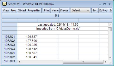

First, we examine the characteristics of individual series. To see the contents of the M1 series, simply double click on the M1 icon in the workfile window, or select Quick/Show… in the main menu, enter m1, and click on OK.
EViews will open the M1 series object and will display the default spreadsheet view of the series. Note the description of the contents of the series (“Series: M1”) in the upper leftmost corner of the series window toolbar, indicating that you are working with the M1 series.

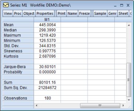

To compute, for example, a table of basic descriptive statistics for M1, simply click on the View button, then select Descriptive Statistics & Tests/Stats Table. EViews will compute descriptive statistics for M1 and change the series view to display a table of results.

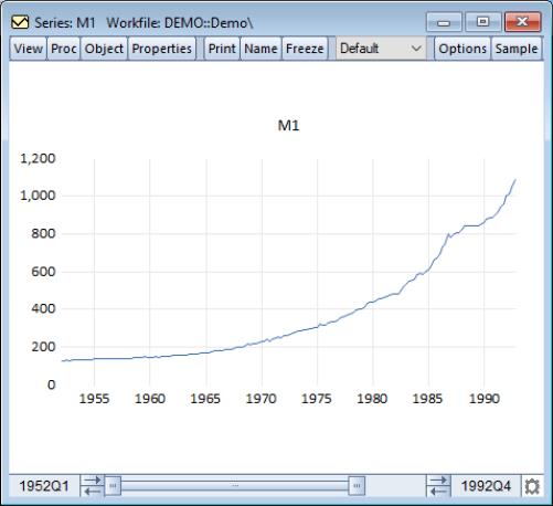

Similarly, to examine a line graph of the series, simply select View/Graph... to bring up the Graph Options dialog, and select Line & Symbol from the list of graph types on the left-hand side. EViews will change the M1 series window to display a line graph of the data in the M1 series.
Note the presence of the slider bar in the bottom of the window which you may drag to show a sub-sample of the observations.

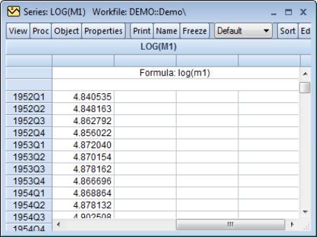

Since our ultimate goal is to perform regression analysis with our data expressed in natural logarithms, we may instead wish to work with the log of M1. Fortunately, EViews allows you to work with expressions involving series as easily as you work with the series themselves. To open a series containing this expression, select Quick/Show… from the main menu, enter the text for the expression, log(m1), and click OK. EViews will open a series window for containing LOG(M1). Note that the titlebar for the series shows that we are working with the desired expression.

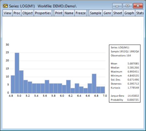

You may work with this auto-series in exactly the same way you worked with M1 above. For example, clicking on View in the series toolbar and selecting Descriptive Statistics & Tests/Histogram and Stats displays a view containing a histogram and descriptive statistics for LOG(M1):

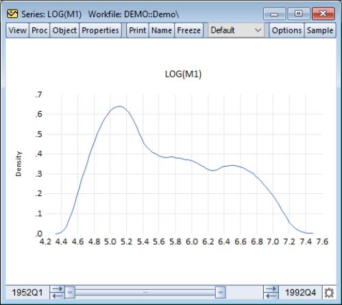

Alternately, we may display a smoothed version of the histogram by selecting View/Graph..., choosing Distribution from the list on the left and Kernel Density from the dropdown on the right, and clicking on OK to accept the default options:

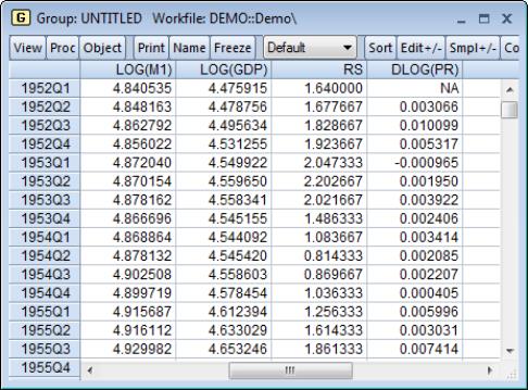

Click on OK to accept the input. EViews will open a group window containing a spreadsheet view of the series and expressions of interest.

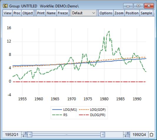

For example, you may select View/Graph... from the group object toolbar, and then select Line & Symbol from the list on the left side of the dialog to display a single graph containing line plots of each of the series in the group:

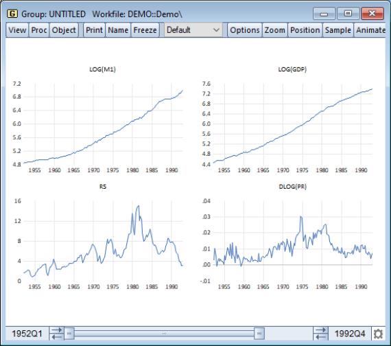

Alternately, you may select View/Graph... and choose Multiple graphs from the Multiple series drop-down on the right side of the dialog to display the same information, but with each series or series expression plotted in an individual graph:

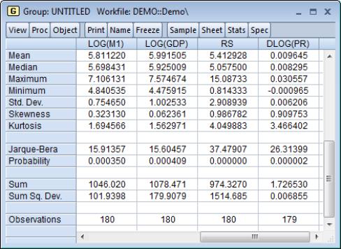

Likewise, you may select View/Descriptive Stats/Individual Samples to display a table of descriptive statistics computed for each of the series in the group:
Note that the number of observations used for computing descriptive statistics for DLOG(PR) is one less than the number used to compute the statistics for the other expressions. By electing to compute our statistics using “Individual Samples”, we informed EViews that we wished to use the series specific samples in each computation, so that the loss of an observation in DLOG(PR) to differencing should not affect the samples used in calculations for the remaining expressions.

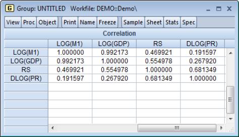

We may instead choose to use “Common Samples” so that observations are only used if the data are available for all of the series in the group. Click on View/Covariance Analysis... and select only the Correlation checkbox to display the correlation matrix of the four series for the 179 common observations:
