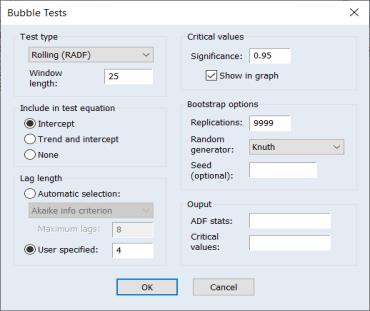

To perform a bubble test in EViews, open the series and click on View/Time Series Diagnostics/Bubble Tests…
The Test type dropdown field allows you to select which type of test you would like to run: Rolling ADF (RADF), expanding window supremum ADF (SADF), or global supremum ADF (GSADF). If RADF is selected, the Window length: field is used to specify the number of observations in each iteration of the rolling tests. If SADF or GSADF is selected, the Initial window length: field is used to specify the number of observations in the first iteration of the expanding tests.
You can specify to include a constant (Intercept), both a constant and a trend term (Trend and intercept), or neither (None) in the ADF test equation using the Include in test equation box.
The Lag length box is used to select either the number of lags to use (User specified:), or the information criteria used, and the maximum number of lags to compare, for Automatic selection:.
The Bootstrap options box defines the options used for the bootstrap procedure used to produce the test p-values. Use the Draws: box to enter the number of bootstrap iterations, and the RNG type: and Seed fields are used to specify the type of random number generator and its seed value.
