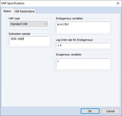

To specify a VAR in EViews, you must first create a Var object. Select Quick/Estimate VAR... or type var in the command window to display the estimation dialog
The Basics tab of the VAR Specification dialog will prompt you to define the structure of your VAR.
We begin with a simple reduced form VAR. You should fill out the dialog with the appropriate information:
• Select the VAR type: Standard VAR.
• Set the estimation sample.
• Enter a list of Endogenous variables in the corresponding edit field. You may list the series individually or you may include one or more series in a group object and enter the group name.
Here we have listed M1, IP, and TB3 as endogenous series
• Enter the lag specification in the Lag Intervals for Endogenous edit box. This information is entered in pairs where each pair of numbers defines a range of lags. For example, the lag pair shown above:
1 4
tells EViews to use the first through fourth lags of all the endogenous variables in the system as right-hand side variables.
Through use of multiple lag pairs you may place zero restrictions on particular lag coefficient matrices , as desired. Simply add any number of lag intervals, all entered in pairs, omitting those lags you wish to restrict. For example, the lag specification:
2 4 6 9 12 12
uses lags 2–4, 6–9, and 12.
Note that restrictions entered in this fashion restrict the entire matrix to be zero. Below, we describe tools that allow for finer discrimination.
• Enter the specification for the exogenous series in the appropriate edit box, using group names if convenient.
Here, we have used the special series “C” to indicate that the VAR has a single constant exogenous term.
For the moment, we will ignore the VAR Restrictions tab of the dialog. Once you have specified your VAR, click on OK to have EViews estimate the coefficient matrices using least squares.

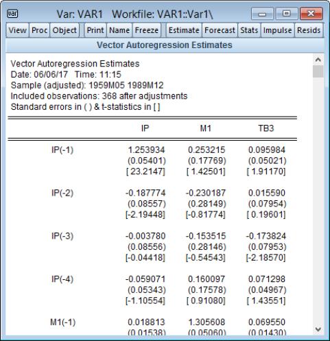

Following estimation, EViews will estimate the model EViews will display the estimation results in the VAR window.
Recall that our VAR specification has three () endogenous variables, IP, M1, and TB3, the exogenous intercept C (), and includes lags 1 to 4 (). Thus, there are () regressors in each of the three equations in the VAR.
As you can see, EViews displays the coefficient results in table. Each column in the table corresponds to an equation in the VAR, and each row corresponds to a regressor in the equation. Note that the regressors are grouped by variable, so that all of the lags for the first variable, here IP, are followed by all of the lags for the second variable, M1, and so on. The exogenous variables appear last.
For each right-hand side variable, EViews reports the estimated coefficient, its standard error, and the t-statistic. For example, the coefficient for IP(-1) in the TB3 equation is 0.095984, the standard error is 0.05021, and the corresponding t-statistic is 1.91170.
EViews displays additional information below the coefficient results. This information is divided into two parts:
• The first part of the additional output presents standard OLS regression summary statistics at the bottom of the column for the corresponding equation (recall that for the standard VAR each equation is estimated separately by OLS).
• The second part consists of summary statistics for the VAR system as a whole. These statistics include the determinant of the residual covariance, log-likelihood and associated information criteria, and number of coefficients:
