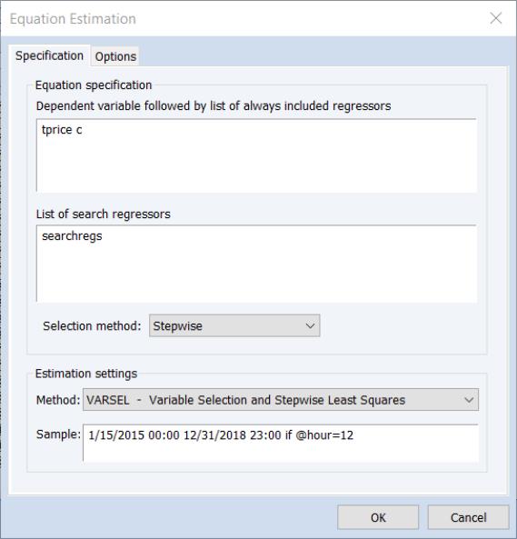

To begin, we’ll use a stepwise regression to select the most appropriate regressors. We click on Quick/Estimate Equation… to bring up the Equation Estimation dialog, and then change the Method dropdown to VARSEL-Variable selection and Stepwise Least Squares.
• We enter “TPRICE C” in the first part of the Equation Specification, and then “SEARCHREGS” in the Search Regressors box.
• We’ll leave the Selection method as Stepwise, and keep the options on the Options tab at their default settings.
• Finally we set the sample to be the estimation dates we want, ensuring that only the noon observations are used.

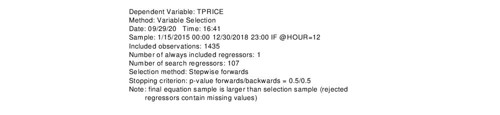

Clicking OK performs the stepwise variable selection, and estimates the final model. The top portion of the output describes the selection process:
The final line issues a warning that the final estimation results shown use a different sample than that used during selection. This is because some of the search regressors contain NAs (due to lags in our case), and thus those observations are dropped from the selection process. However some of those variables were not selected, and so those observations can be re-included in the final estimation.

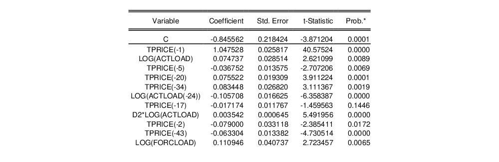

The middle part of the output (partially shown here) displays the selected variables, their coefficients, standard errors, t-statistics and probability values.

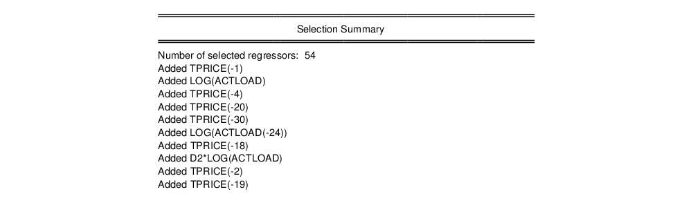

In this case a total of 54 of the 107 search regressors were selected.
The bottom of the output (partially shown) describes the selection process the stepwise regression undertook.

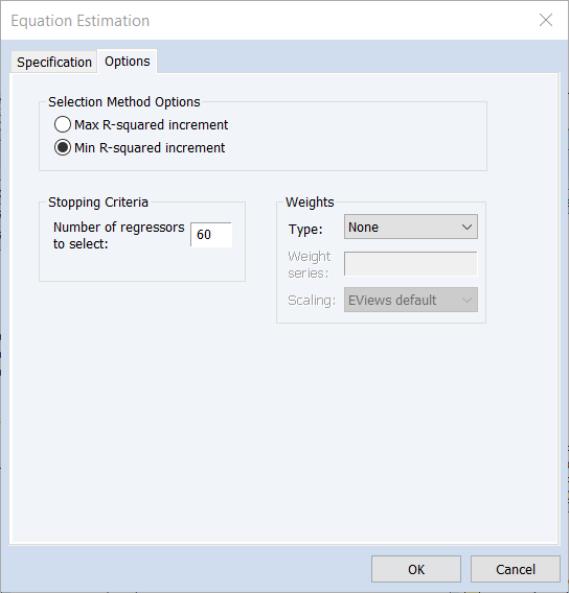

For a second estimation of the model, we will use the swapwise algorithm. We again click on Quick\Estimation Equation to bring up the Equation Estimation dialog, and fill in the variables and sample as before. We change the Selection method combo to Swapwise.
Switching to the Options tab, we switch to Min R-squared increment and instruct EViews to find the best 60 regressors (which seems a reasonable number given the stepwise procedure’s selection of 54).
The output from this equation is similar to that of the first—the top portion displays a summary of the estimation, the middle section provides the estimation results, and the bottom portion displays the selection process.

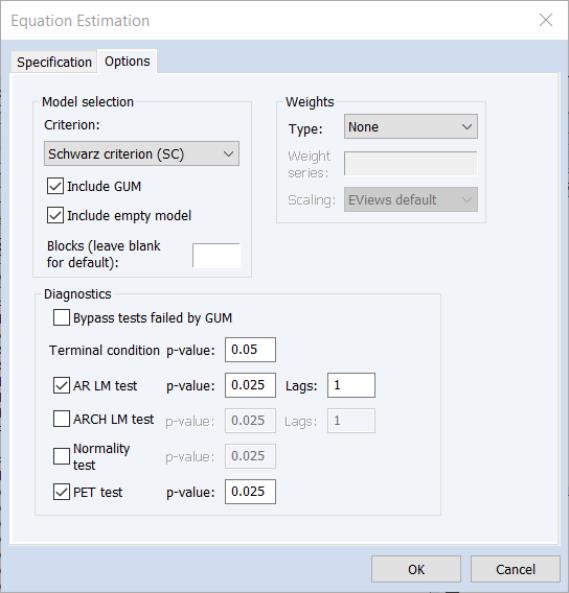

Our third estimation will use the Auto-search/GETS algorithm. On the Specification page, change the Selection method to Auto-Search/GETS, and then click on the Options tab to alter some of the default settings. We’ll change the criteria used to decide between the final candidate models to the Schwarz criterion using the Criterion dropdown. We also elect to only use the AR LM test and PET tests as diagnostic tests during the path search.
The output from this estimation is similar to the previous two; the upper portion describes the selection method, the middle displays the final model’s coefficient estimates and associates statistics, and the bottom provides some small detail on the selection process. In contrast to the stepwise procedure, Auto-search has only selected 27 regressors.

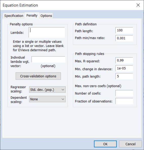

In this example employ Lasso to select a model for the electricity data. On the Specification page, change the Selection method to Lasso,
We leave the Penalty page settings at their default values, but click on the Cross-validation options button and change the K-fold Objective to Symmetric MAPE and the Number of folds to 20. Click on OK to accept the Cross-validation Options and then click on OK to estimate the model using the specified settings.

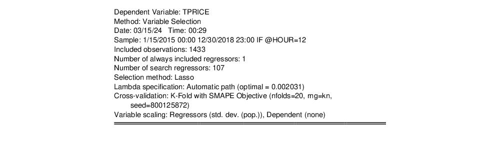

The top of the main estimation output shows information about the Lasso estimation settings:

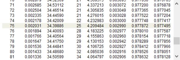

Among other things, EViews uses an automatic path determination to specify the , and employs K-Fold cross-validation with a SMAPE objective to determine an optimal penalty. The optimal is 0.002031.

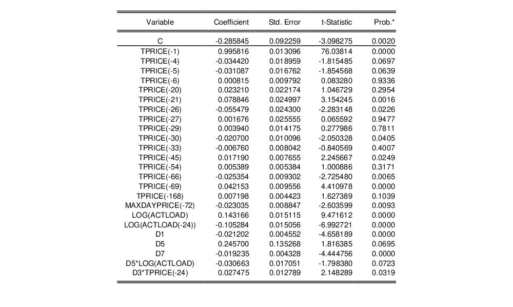

The middle portion of the output shows the results for OLS estimation using the variables with non-zero coefficients in the Lasso estimation.

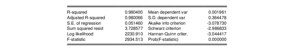

Below the OLS coefficients are the usual summary statistics:

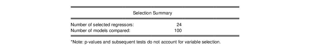

The bottom of the output reports that the cross-validation model selection compared 100 values of the penalty parameter. Lasso selects 24 regressors out of the 107 search regressors.
EViews also reminds you that the standard errors, p-values, and test results reported in this table are for OLS given the variables selected, and do not account for the randomness associated with Lasso variable selection.

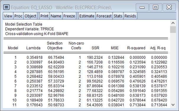

The Criteria Table view shows the cross-validation objective and other fit statistics in tabular form, ordered by value of the penalty. The optimal value will be highlighted.

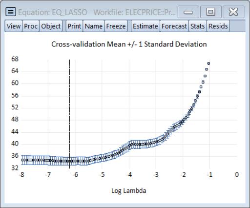

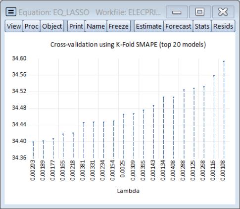

Selecting View/ Model Selection/Cross-validation Error Graph, shows a graph of the full path of the cross-validation evaluation statistic:

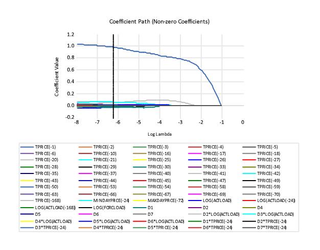

Under the View/Model Selection menu EViews also offers views from elastic net estimation. Of particular interest is the Coefficients Path Graph view which (among other graphs) plots the (anywhere) non-zero coefficients against the lambda path:
