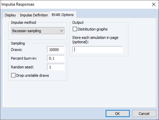

Impulse Response
To produce impulse response graphs and tables, you may select View/Impulse Response... As with other VAR estimation methods, the first two tabs of the dialog (Display and Impulse Definition) will prompt you to select which impulses and responses to display in graph or table form, and to define the impulses you wish to produce.
The impulse response dialog for Bayesian VARs has an additional BVAR Options tab that contains Bayesian Specific settings:
The Impulse method dropdown menu selects the method for computing the impulses:
• Bayesian sampling will generate responses using draws from the posterior distribution over model parameters.
• Classical – posterior res cov. performs classical impulse response analysis where the impulses are calculated based upon the posterior residual covariance.
• Classical – empirical res cov. performs classical impulses response analysis where the impulses are calculated based upon the empirical residual covariance.
If Bayesian sampling is selected as the impulse method, the Sampling and Output options allow you to customize the sampling and store output:
• Draws sets the number of iterations of the sampler
• Percent burn-in sets the number of draws to discard.
• Random seed sets the random number generator’s seed.
• The Drop unstable draws checkbox determines whether EViews will throw out and re-sample any draw which results in VAR coefficients that produce an unstable VAR. Note that checking this box may severely increase the time taken to produce the impulses if the posterior probability that the VAR is stable is low.
• The Distribution graphs check box will produce kernel-distribution plots of the draws for each variable pair and each period of the responses.
• The Store each simulation in page edit field allows you to enter the name of a page in which to store each individual draw of the sampler. If a name is entered into this box, a new page with that name will be created in the workfile, structured as a panel with one dimension representing the number of response periods, and the other corresponding to the number of posterior draws. EViews will create a series for each variable pair in the new page.

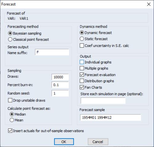

Forecasting
Selection Proc/Forecast... displays the forecast dialog which offers a choice between Bayesian or classical forecasting:
By default, EViews will produce forecasts using Bayesian sampling, but you may select the Classical point forecast radio button to use the estimated coefficients to produce a point forecast.
If Bayesian sampling is selected, the Sampling and Output options allow you to customize the sampling and store output as in Bayesian impulse response calculation:
• The Store each simulation in page edit field allows you to enter the name of a page in which to store each individual draw of the sampler. If a name is entered into this box, a new page with that name will be created in the workfile, structured as a panel with one dimension representing then umber of response periods, and the other corresponding to the number of non-burned in sample draws. EViews will create a series for each variable pair in the new page.
