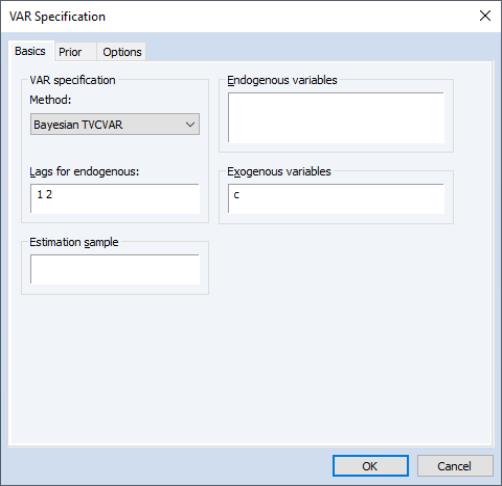

To estimate BTVCVAR in EViews, click on Quick/Estimate VAR... or run var in the command window. EViews will open the VAR Specification dialog. Select Bayesian TVCVAR from the VAR type dropdown menu to display the TVCVAR dialog:
The dialog has three distinct tabs (Basics, Prior, and Options).
The endogenous variables, lag specification, exogenous variables, and the estimation sample are set in the Basics tab. The lags are required to be contiguous.
EViews gives users the option of setting aside a subset of the estimation sample for the purpose of specifying a prior distribution. The observations that go towards specifying the prior comprise the prior sample. The remaining observations make up the data sample, which is used to update the prior. See “Prior Specification” for details.

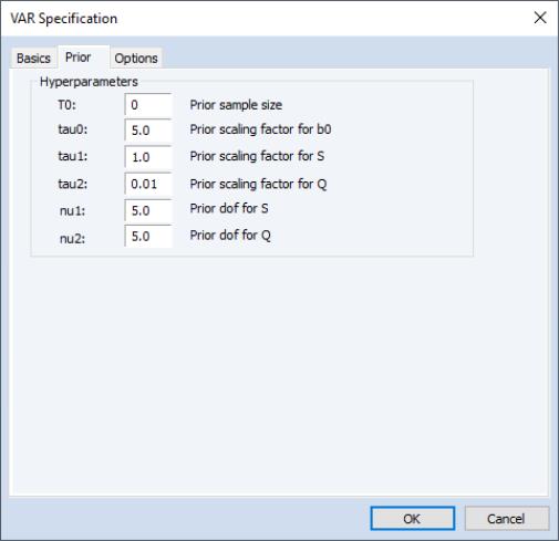

Prior hyper-parameters are set inside the Prior tab. To help with setting the prior, EViews maps the BTVCVAR prior hyper-parameters to a set of six scalar quantities. Users set these scalars to specify a prior sample, control the variability of the time-varying coefficients, etc. See the “Prior Specification” for details.

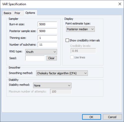

There are four categories in the Options tab: Sampler, Display, Smoother, and Stability.
The Sampler options determine how the posterior sample is generated.
• The Burn-in size is the number of initial draws to discard. It is specified as a count. The burn-in process gives the underlying Markov chain time to converge to the posterior distribution.
• The Posterior sample size is used to determine how many posterior draws are used to carry out post-updating procedures (estimation, forecasting, impulses responses analysis, etc.).
• The Thinning size is used to thin the Markov chain. A thinning size of indicates that every -th draw is stored. For example, no thinning occurs when is set to 1, and every other draw is stored when is set to 2. By definition, thinning does not apply to burn-in draws.
• The Number of subchains field determines how many subchains are used when the posterior sample gets regenerated. Regeneration is typically much faster than initial generation since subchains can be run in parallel.
• The RNG type and Seed field is used to set the random number generator and the random seed for the posterior simulator. EViews will generate a seed automatically if the user does not specify one. Click Clear to clear the seed field.
Display options determine what to report as estimation results. Users can pick either posterior median or posterior mean as their point estimate. The point estimate type selected here will be applied to the coefficients, the observation covariance matrix, and the errors. Users can also display equal-tailed credibility intervals (bands) at one or more credibility levels for the coefficients. To do so, check the box next to Show credibility intervals. Bands use shading by default. To use lines instead, check the box next to Use lines.
A simulation smoother can be selected from the dropdown menu under Smoother. EViews currently supports three simulation smoothers: the Cholesky factor algorithm (CFA), the Kalman filter and smoother (KFS), and the method of McCausland, Miller, & Pelletier (MMP). For more information, see McCausland, Miller, & Pelletier (2011) and the references therein.
To enforce stable VAR coefficients at each date within the data sample, select Cogley & Sargent from the dropdown menu under Stability. The maximum number of attempts threshold ensures that the sampler does not get stuck in an infinite loop in an attempt to obtain stable draws.
