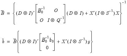

Posterior Full Conditional for b
Let
 | (48.6) |
where the
's are zero matrices. Let  | (48.7) |
denote the square
matrix of first differences. Then  | (48.8) |
where
 | (48.9) |
