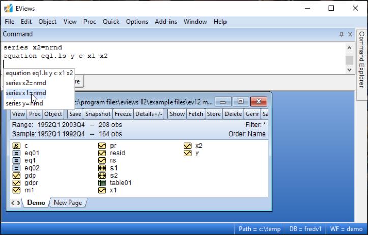

When you enter a command, EViews will add it to the list of previously executed commands contained in the window. You can scroll up to an earlier command, edit it, and hit ENTER. The modified command will be executed. You may also use standard Windows copy-and-paste between the command window and any other window.
EViews offers a couple of specialized tools for displaying previous commands. First, to bring up previous commands in the order they were entered, press the Control key and the UP arrow (CTRL+UP). The last command will be entered into the command window. Holding down the CTRL key and pressing UP repeatedly will display the next prior commands. Repeat until the desired command is displayed.
To look at a history of commands, press the Control Key and the J key (CTRL+J). This key combination displays a history window containing the last 30 commands executed. Use the UP and DOWN arrows until the desired command is selected and then press the ENTER key to add it to the command window, or simply double click on the desired command. To close the history window without selecting a command, click elsewhere in the command window or press the Escape (ESC) key.

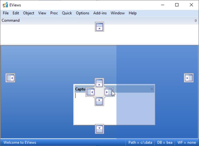

Both the command and capture window panes can now be docked on any side inside the main EViews window. Begin dragging the pane by left-clicking title bar and holding it down as you drag it off the edge. At that point, you will see small docking guides appear inside the main EViews window:
To dock the window, you will drag it to one of the docking guides. The docking behavior will depend on which guide you select.
The docking guides allow you to dock the window pane to one of eight pre-defined areas. The four guides on the outer edge of the main window allow you to dock the window as the primary pane while the inner guides allow you to dock the window as a secondary pane. Primary panes take over the entire length of the selected edge and force other docked panes that could intersect to become smaller to compensate. Secondary panes only take over the portion of the selected edge that is not already occupied.

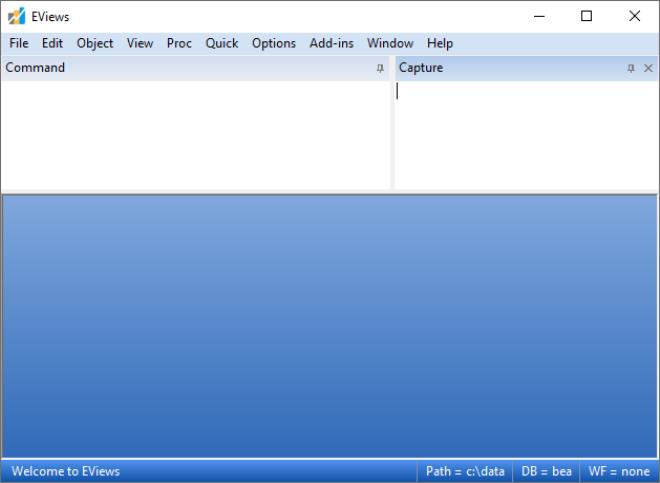

For example, selecting the inner-right guide area allows the Capture pane to appear to the right of the Command pane with an adjustable split bar to let you resize the split:

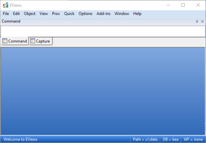

The docking guide also offers an additional guide area directly in the center that allows you to convert both panes into a tabbed view:
