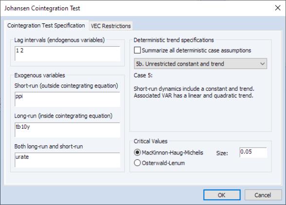

We may carry out a Johansen cointegration test to determine the cointegrating rank. This test is available from a group window using View/Cointegration Test/Johansen System Cointegration Test..., or from an estimated VAR object window using Views/Cointegration Test...
Suppose we have open an estimated VAR object, click on Views/Cointegration Test... and fill out the test dialog as follows:
Click on OK to perform the test. The output is a spool object with 4 tables:

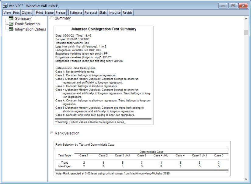

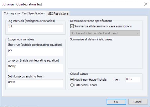

It is possible to conduct a battery of rank tests for each of the deterministic assumptions that are available for estimation. To do this, proceed from the previous example and click on Views/Cointegration Test... to once again bring up the testing dialog.
This time, click on Summarize all deterministic case assumptions and hit OK.

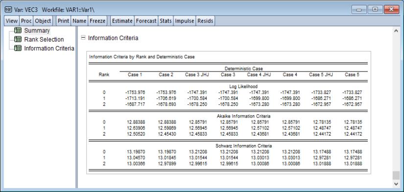

The top portion of the spool output shows the test settings and assumptions, along with the rank selection results broken down by test type and deterministic case:
The remainder of the output shows the information criteria broken down by rank and deterministic case:
