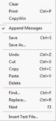

logmode command gives the ability to specify the name of the log window and directs the messages to the window with the specified name. If no name is specified the messages are directed to a window with the name of the program. If a program is executed more than once and a log window has already been created, with no name specified for the log, the log window will be cleared and all subsequent messages will be sent to the existing log window. If you wish to preserve a log, you may either select to append message, save the log to a text file, or freeze it, which creates a text file object. All of these actions can be accessed by the popup menu that appears when right-clicking on a message log window.
