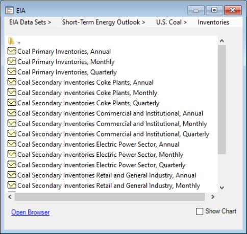

EIA (U.S. Energy Information Administration)
Online EIA Database
Offline EIA Bulk File - U.S. Energy Information Administration Databases

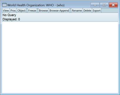

World Health Organization

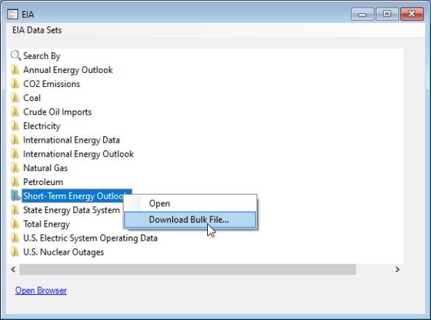

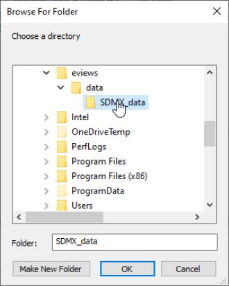

Online EIA Database

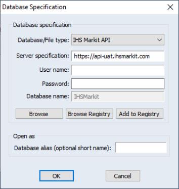

IHSMarkit

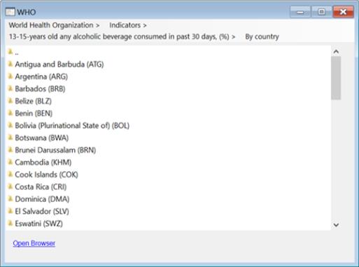

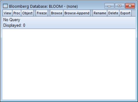

The following discussion offers a quick introduction to use EViews to connect with Bloomberg data. See our whitepaper: Bloomberg Database Extension for EViews (available from our website www.eviews.com/download/download.html) for additional detail and discussion.

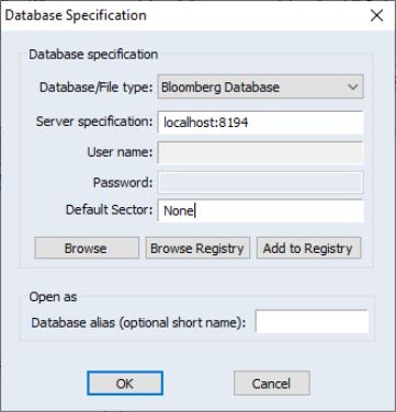

To start, you must open a database window to Bloomberg by selecting File/Open Database… from the main EViews menus, then selecting Bloomberg Database from the Database/File type dropdown menu. The following dialog should appear:
In most cases, you should simply be able to click on OK to get started. Clicking on OK should bring up a Bloomberg database window.

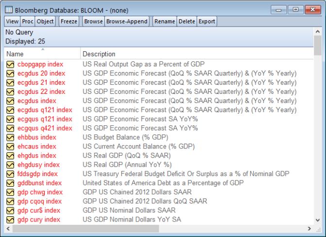

The database window represents a connection to Bloomberg data.

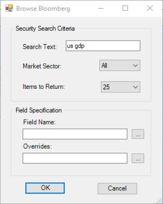

The first step in retrieving data is to find a series that we would like to fetch. Click on Browse to bring up the Bloomberg database custom search dialog:
• The Search Text field allows you to enter one or more keywords to search for. The ‘Market Sector’ field lets you restrict the search to a particular Bloomberg market sector. (If you are using a Bloomberg keyboard you can change the market sector field by pressing a Yellow Key).
• The Items to Return field specifies how many items to return from the search. Bloomberg is very effective at selecting relevant results so only a small number of results is generally needed.
• The Field Name and Overrides boxes allow you to specify what particular information about a security you would like to fetch. By default EViews will fetch the field “PX_LAST” without any overrides.
For example, we can simply type “us gdp” into the Search Text box and press OK. You should return to the database window with the following search results displayed:
Any series displayed in the database may be manipulated following the usual EViews interface conventions:
• Double click on a series to bring up detailed information on the series
• Drag and drop series or copy and paste them into an EViews workfile or database to fetch the current data from the server (drag with the right mouse button or use Paste Special to create links)

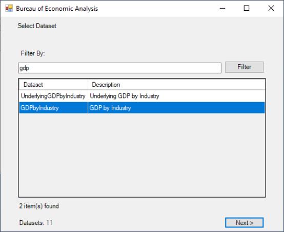

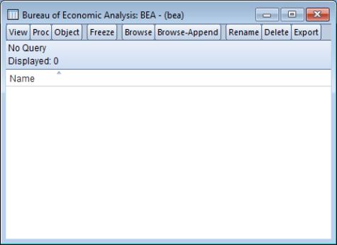

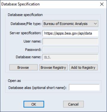

EViews offers a custom interface to BEA data. To open the BEA database, select File/Open Database… from the main EViews menu, then select Bureau Of Economic Analysis from the Database/File type dropdown menu:
Use of the BEA service is free but requires registration. The first time you attempt to open the database you will be asked to enter an API Key obtained from the Bureau of Economic Analysis:
Please enter your API key and then click on OK. The key will be saved as a user specific setting in your EViews “.ini” file. If you need to change the key at a later time, select View/Preferences… from the EViews database menu to modify your settings.

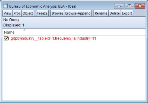

When you click on OK, EViews will open a standard database window:
Click on Browse to open the custom BEA window:

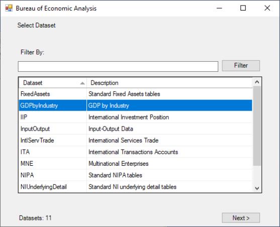

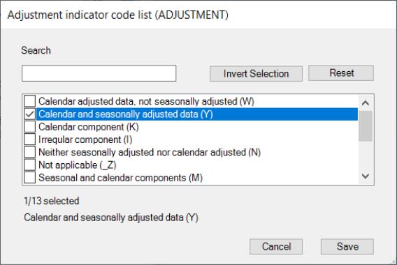

The dialog allows you to select data available within datasets. The browser interface to the data provides a way to search through the datasets by typing a keyword in the Filter By textbox and clicking the Filter button:

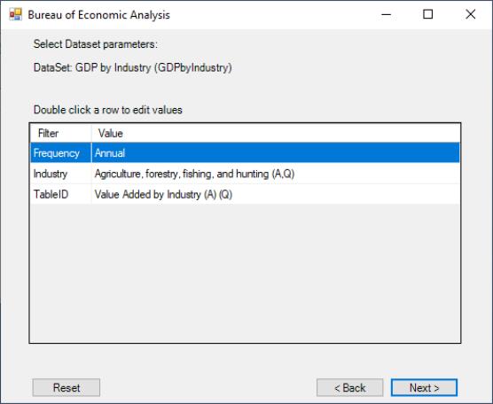

Select a dataset and click the Next > button. A dialog with a list of dataset parameters will be shown, which will allow you to filter and customize the search results of the available series objects in the selected dataset. The default parameters are displayed under the Value column of the data table. Double click the row the change the default values.
Click the Reset button to clear the selections, the Back button to navigate to the previous window, or the Next button to view the available series:

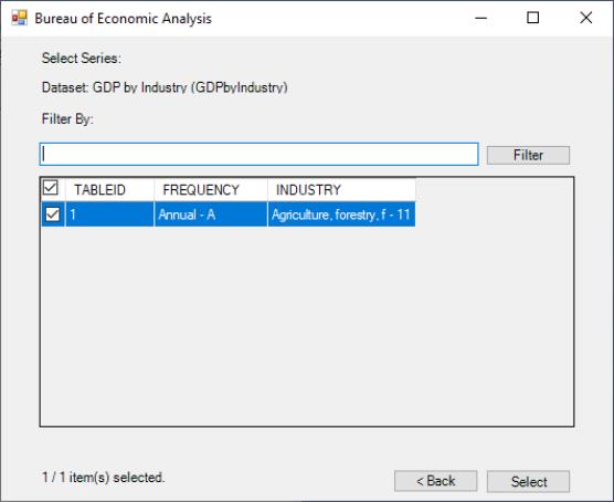

A dialog containing a table with all the available series is displayed. The interface provides a way to search through the series by typing a keyword in the Filter By textbox and clicking the Filter button. Click the Select button to select the series:
Once you have found the series of interest, you may drag-and-drop (or copy-and-paste) the series directly into an EViews workfile in the usual fashion.

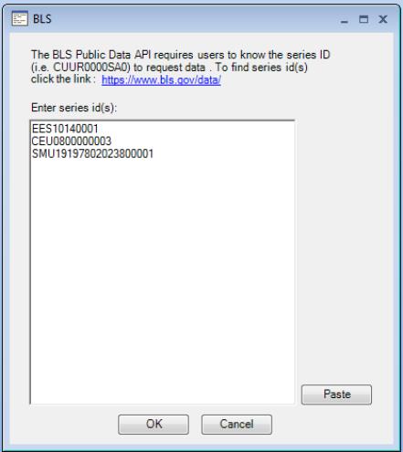

Bureau of Labor Statistics (BLS)
The BLS database is a large collection of free and publicly available economic data provided by the Bureau of Labor Statistics of the U.S. Department of Labor.

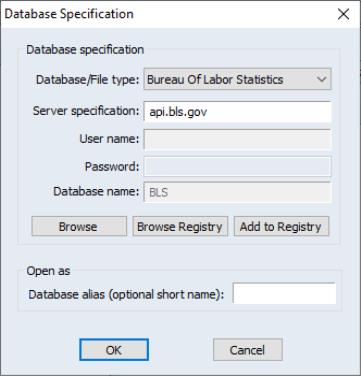

EViews 10 offers a custom interface to BLS data. To open the BLS database, select File/Open Database… from the main EViews menu, then select Bureau Of Labor Statistics from the Database/File type dropdown menu:
The server specification will be automatically filled in with the BLS server address api.bls.gov, which you should not need change. Click on OK to proceed.

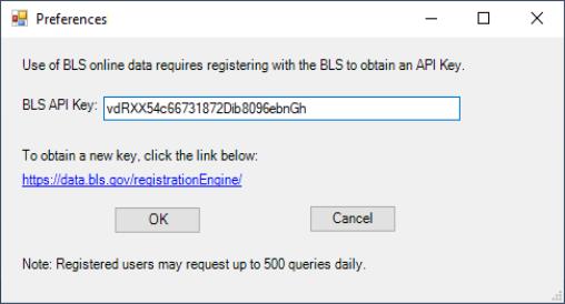

Use of the BLS service is free but requires registration. The first time you attempt to open the database you will be asked to enter an API Key obtained from the Bureau of Labor Statistics:
Please enter your API key and then click on OK. The key will be saved as a user specific setting in your EViews ".ini" file. If you need to change the key at a later time, select View/Preferences… from the EViews database menu to modify your settings.

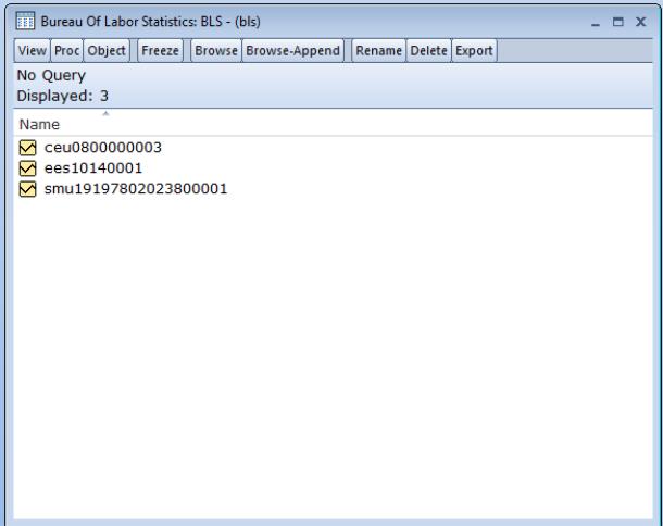

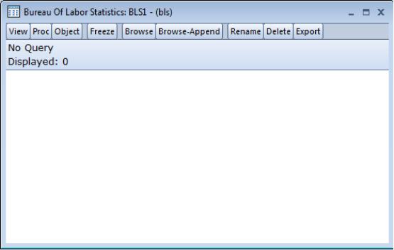

Click on Browse to open the custom BLS window. The standard database window will be minimized and the BLS window will open:
The browser window displays an edit box where the user can type or Paste one or more series IDs to be retrieved from BLS. In the example above the edit box contains three typed series. After clicking OK, the regular EViews database window will be restored and will contain any requested series.
Please note that the BLS Data API requires users to know the series ID to request data.
Once you have found the series of interest, you may drag-and-drop (or copy-and-paste) the series directly into an EViews workfile.

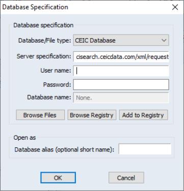

CEIC
The CEIC database includes economic, sector and financial data. Data are fetched from the internet by Internet Securities, Inc. (also known as IS Emerging Markets) XML based data servers.
The CEIC database interface is not available in EViews Standard Edition.
To access CEIC data, the CEIC-EViews Interface Software must already be installed on the client machine. To obtain the software and a valid CEIC account, please contact Internet Securities, Inc. directly. For additional information, please see http://www.securities.com.
To access a CEIC database, select File/Open/Database... and select CEIC Database in the drop-down menu and fill out your User name and Password as prompted. The Sever specification is pre-filled with the CEIC default, but you may enter the specification information for a different server if desired:
You may optionally provide a Database alias. Click on OK to open the database in the standard EViews interface.

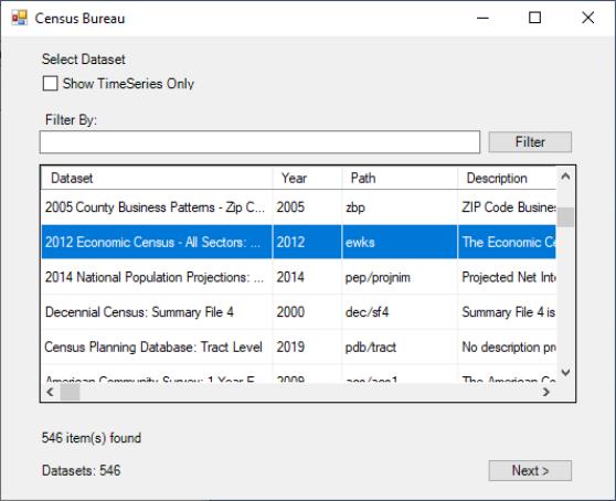

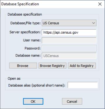

EViews offers a custom interface to the Census data. To open the Census database, select File/Open Database… from the main EViews menu, then select US Census from the Database/File type dropdown menu:

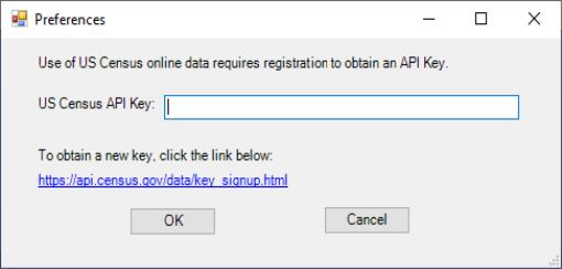

Use of the Census service is free but requires registration. The first time you attempt to open the database you will be asked to enter an API Key obtained from the United States Census Bureau:

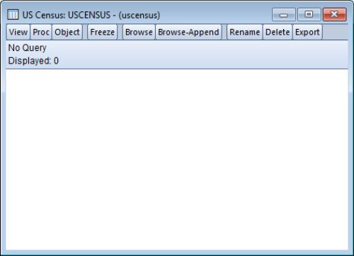

Click on Browse to open the custom Census window:

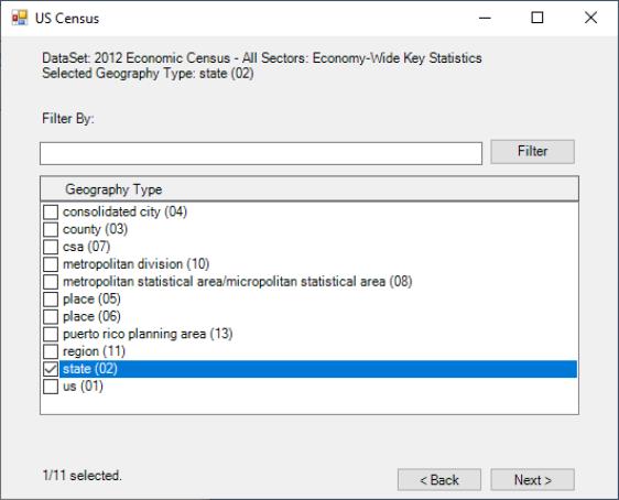

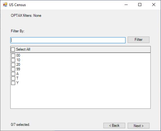

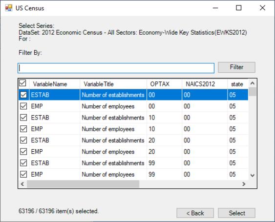

The dialog displays the available datasets. The checkbox Show TimeSeries Only is checked by default. Uncheck the box if you want to see all available datasets. The browser interface to the datasets provides a way to search through the datasets by typing a keyword in the Filter By textbox and clicking the Filter button. Select a dataset and click the Next button. A dialog with a list of variables will be shown, which will allow you to filter and customize the search results of the available series objects in the selected dataset:
The variables that are preselected are required variables for the search; you may select additional variables you are interested in. You can search through the variables by typing a keyword in the Filter By textbox and clicking the Filter button. Click the Next button to navigate to the next dialog:
The majority of Census datasets require the user to specify geographic information in order to customize and limit the data result. After selecting the geography type, click Next to navigate to the next dialog. You might need to navigate to a number of dialogs until the geographic order is met:
Select one or more geography options and navigate to the next dialog. If there are any variables required by the dataset you will be asked to choose available values:
Once you finish selecting geography and required variables information, a dialog that contains a table with all the available series is displayed. The interface provides a way to search through the series by typing a keyword in the Filter By textbox and clicking the Filter button.

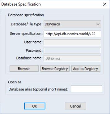

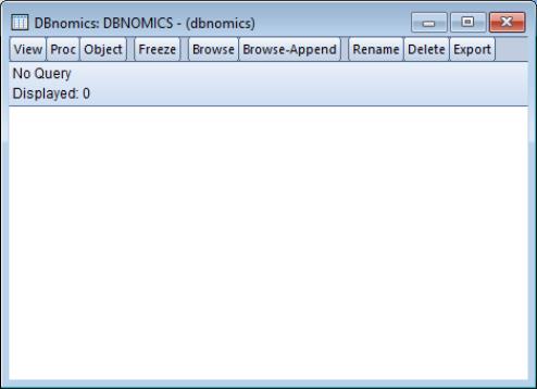

EViews offers a custom interface to the DBnomics data. To open the DBnomics database, select File/Open Database… from the main EViews menu, then select DBnomics from the Database/File type dropdown menu:

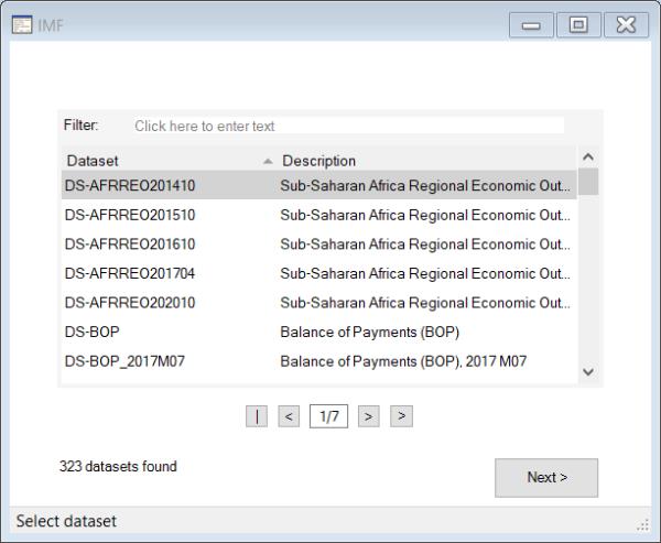

Click on Browse to open the custom DBnomics window:

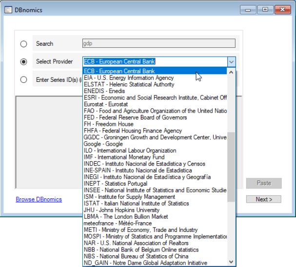

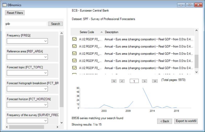

The dialog interface allows you to continue your search for data by searching for a keyword, by selecting a provider, or by typing known series ids.

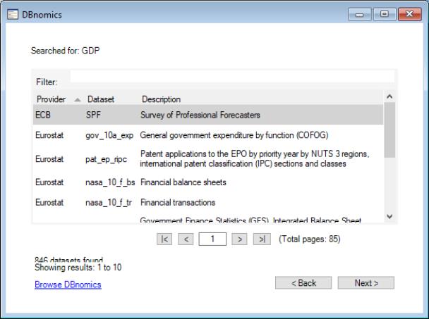

There are three methods to find the data you want. To search directly, click the Search radio button and type a keyword in the textbox. Use the Next button to view the results of the search:
A dialog that contains a table with all providers and datasets related to the keyword searched (GDP in this case) is displayed. The interface provides a way to filter through the results by typing a keyword in the Filter textbox. It also provides a textbox and buttons to navigate through pages of results. Click the Next button or double-click on a row to select a provider and a dataset.

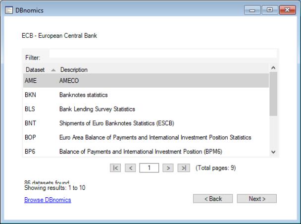

To select by data provider, click the radio button Select Provider and choose one of the entries listed in the drop-down box:
Use the Next button to view the results in a dialog that contains a table with all datasets related to the specified provider (in this case, ECB).
The interface provides a way to filter through the results by typing a keyword in the Filter textbox. You may use the textbox and buttons to navigate through multiple pages of results. Click the Next button or double-click on a row to select a dataset.
The Search and Select Provider options will display a dialog where the user can view and select series. For the GDP search example, we may select the ECB provider using the SPF dataset:
This dialog contains a table where all the series matching the search are displayed. The interface provides a textbox where search criteria can be viewed or changed. It also provides a list of dropdown boxes that contain additional search filter criteria. By clicking a filter drop box one or more options can be selected. After selections are made the results of series will be updated to match the filter options. The interface also provides a graph preview of the data selected.
Once you have found and selected the series of interest, you may drag-and-drop or click the Export to workfile button to export the series directly into an existing or new EViews workfile.
The third option is to enter a Series ID. Click the radio button Enter Series ID(s) and enter one or more series codes in the text area:
Use the Next button to view the series:
EViews displays a dialog that contains a table with all the series. The interface provides a way to filter through the results by typing a keyword in the Filter textbox. It also provides a graph preview of the series data selected.

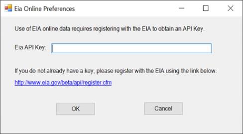

To open the EIA online database, simply select File/Open Database… from the main EViews menu, then select EIA - U.S. Energy Information Administration from the Database/File type dropdown menu:
The server specification will be automatically filled in with the EIA server address “api.eia.gov”. This does not need to be changed. Click on OK to proceed.
Use of the EIA online service is free but requires registration. The first time you attempt to open the EIA online database you will be asked to enter an API Key obtained from the EIA:
Please enter your API key and click on OK. The key will be saved as a user specific setting in your EViews “.ini” file. If you need to change the key at a later time, use View/Preferences… from the EViews database menu to bring up the dialog again so you can modify your settings.

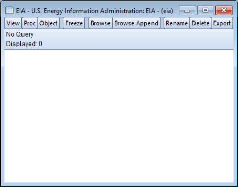

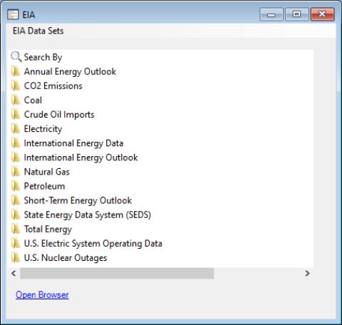

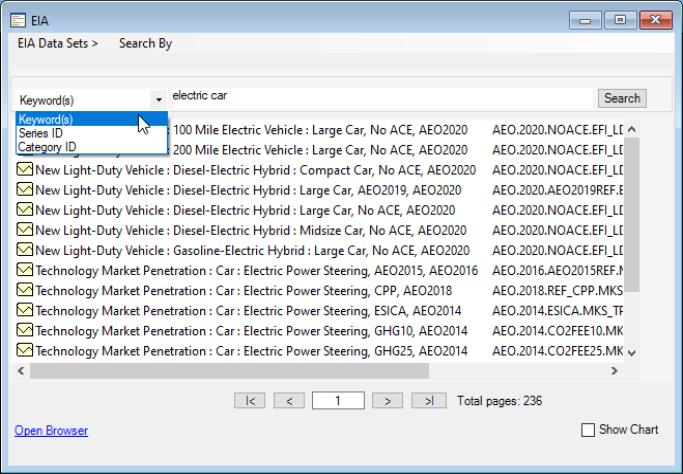

The EIA database connection supports a custom browser window for navigating through the EIA data. Click on Browse to open the custom browser window. The standard database window will be minimized and the EIA browser window will open:
The browser window displays a Search By link and the data sets available within the database as a set of folders, where each folder may contain additional folders or a list of series available for download. Clicking on a folder moves you into that folder and adds the folder to the path displayed at the top of the window:
You can return to the previous folder by clicking on the “..” folder icon at the top of the list, or move directly to any folder within the current path by clicking on the path component at the top of the window.

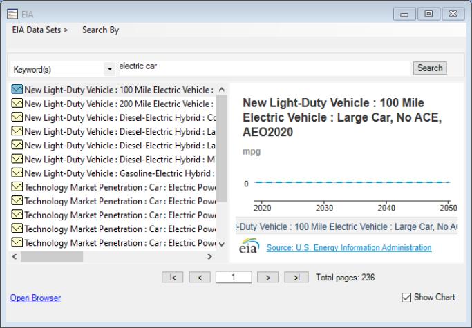

Select the Show Chart checkbox at the bottom right of the dialog to view a chart of a selected series:
All the dialogs contain a link (Open Browser) to the API. Click on the link to get additional information including documentation.
Additionally, the EIA Edx allows the user to search for one or multiple series. Click on the Search By link to search for series by Keyword(s), Series ID, or Category ID.
You can select the Show Chart box to view the chart of a selected series:
Once you have found and selected the series of interest, you may drag-and-drop or copy-and-paste the series directly into an EViews workfile. When you have finished working with the browser, simply close the browser window to restore the regular EViews database window.

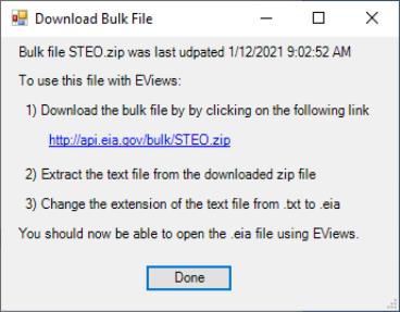

EViews also allows you to work offline with data downloaded from the EIA using the EIA bulk download facility. The bulk download feature allows you to fetch all series and category information from an entire EIA data set into a single local file. Downloading an entire bulk file is generally much more efficient than fetching a large number of series one at a time. Once the file has been downloaded, you can navigate within the dataset and bring data into EViews without reconnecting to the EIA servers.
To download a bulk file, open the browser window of the EIA online database, right click on a data set, then select Download Bulk File…:
A dialog will appear giving instructions for downloading the file and preparing it for use by EViews:
Clicking on the download link will open your default web browser and start a download of the file. The bulk file is compressed in “.zip” format. You will need to use an unzipping utility to extract the single “.txt” file contained within the zip file.

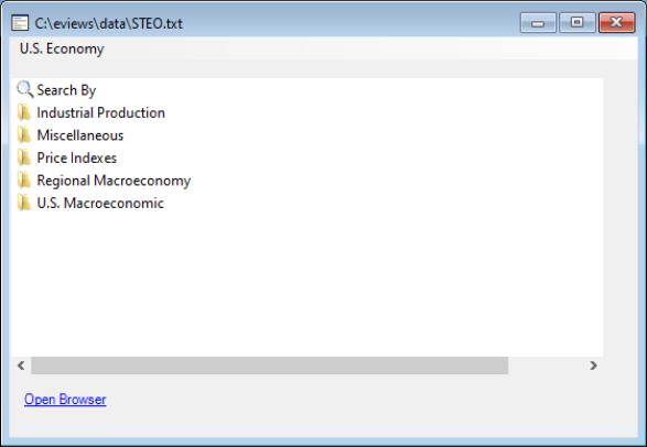

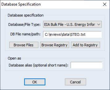

Once the bulk file is ready, use File/Open Database/EIA Bulk File - U.S. Energy Information Agency… , then click on Browse Files to find the file, and then OK to open it:
Alternatively, you can drag and drop the file onto EViews to open it. First, however, you should rename the “.txt” file to “.eia” so EViews can tell that the file contains data in EIA bulk file format and is not a generic text file.
The caption on the window indicates that you are working with a local file. Otherwise, the interface behaves the same as when working with online data:

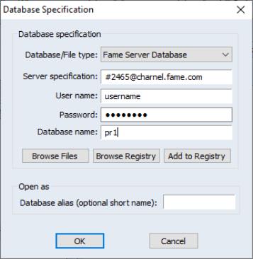

EViews also allows access to FAME databases located on a FAME Database Server. When working with a FAME server, the Server specification should be given in the form:
#port_number@ip_address
For example, the server specification for access to a FAME/Channel database might appear as:
#2552@channel.fame.com
Access to a server will require a valid username and password for that server.

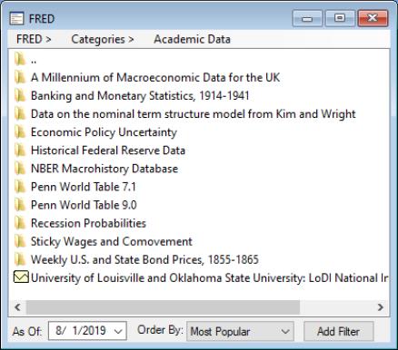

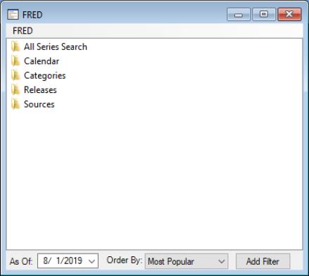

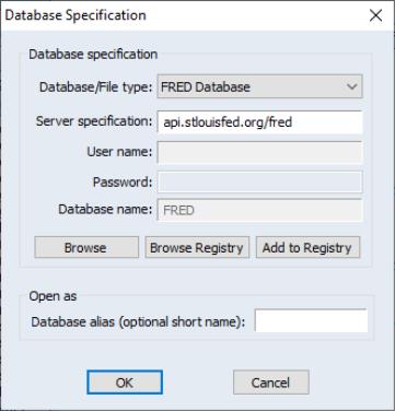

EViews offers a custom interface to the FRED data service provided by the Federal Reserve Bank of St Louis. The interface includes a custom browser for navigating the available FREDX data and adds support for retrieval of historical releases. To access the FRED database, use File/Open Database… from the main EViews menus and choose “FRED Database”:
Click on OK to open the online database. You will be presented with a standard EViews database window with the Query and Easy Query search interface. Click on Browse or Browse–Append, which will open an all new custom FRED database. Click on the folder icons to drill down into subtopics:
The browser allows you to find data available within FRED by navigating through a set of nested folders. Simply click on any folder to move inside it.
The full path of the active folder will be shown in the header at the top of the window. You can click on any folder within the path to navigate back to that folder. Here, clicking on Categories will move back up a single level to show the category choices. Similarly, clicking on the “..” in the window listing will move up a single level.

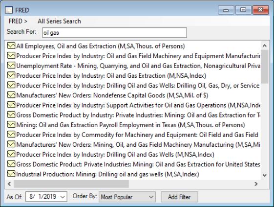

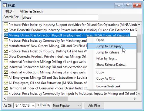

The browser interface to FRED offers a number of useful tools for working with your FREDX database:
• Clicking on the All Series Search folder in the FRED root directory changes the interface to allow searching by keyword. Simply enter one or more keywords into the Search For box and EViews will display a list of series that match those keywords.
• You can use the Order By combo to change the order in which series are listed. By default, EViews will show the Most Popular items first, but you can order by alphabetical Description order, Recently Updated, Earliest Values, Latest Values, Highest Frequency, and Lowest Frequency.
• You may click on the Add Filter button to narrow the display list. Filters will be displayed at the top of the window and may be modified, disabled, or removed by clicking on the filter description in the header.
• You may use the As Of dropdown calendar to restrict the data to a particular vintage, which is handy when trying to match a particular data revision.
• Right-clicking on items in the browser will bring up a menu with items for performing useful tasks:
1. Jump to Category can be used to navigate directly to the folder within the category tree that contains the selected series. If the series appears in more than one category, a list will appear for you to choose which of the folders you would like to navigate to.
2. Jump to Release can be used to navigate directly to the statistical release that contains the selected series.
3. Filter by tags allows you to see the list of tags attached to a particular series. Tags are standardized concepts that may be used to filter which series are displayed within the browser window. You may check or uncheck the tags of a series to adjust the filtering currently in effect:

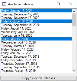

4. The Show Release Dates menu item displays a list of release dates for the selected series. You may use this information in conjunction with the As Of dropdown to retrieve the historical version of a series.
5. The Copy As Of right mouse button menu item allows you to retrieve multiple historical revisions at once. Simply select one or more series in the browser window, then click on Copy As Of to see a list of available releases. Select the releases you would like to copy by clicking on them then click on the Copy Selected Releases button at the bottom of the screen.

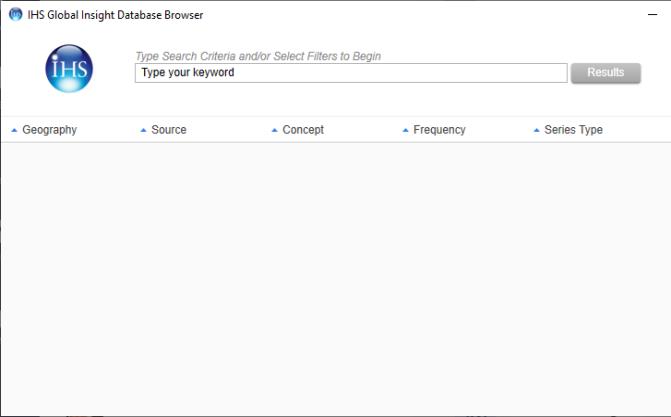

IHS Global Insight

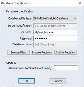

The IHS Global Insight Database is a large and frequently updated international data offering for over 200 global markets. The Global Insight Database offers a modern interface for accessing the same data offered through the IHS Magellan interface.
To access the Global Insight Database you must have a valid IHS MyInsight username and password, which can be requested from the IHS webpage ( http://www.ihs.com/products/global-insight/data-analytics/index.aspx).
The IHS Global Insight database interface is not available in EViews Standard Edition.
To open a connection to the IHS Global Insight Database, select File/Open Database… from the main EViews menu, then select IHS Global Insight Database from the Database/File type dropdown menu:
EViews will launch the Global Insight Database Browser, allowing you to search the database of series available from IHS:
For more information see the PDF guide to using the IHS Global Insight Database Browser from within EViews, available from our website: www.eviews.com/download/download.html.

IHSMarkit provides access to financial data from a large number of datasets. To access IHSMarkit data from EViews, you must have a currently active account to the IHSMarkit data API and be able to log into it on your machine.
The IHSMarkit database interface is not available in EViews Standard Edition.

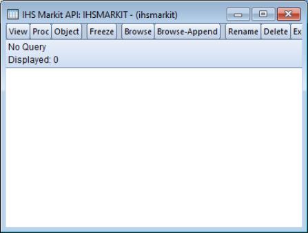

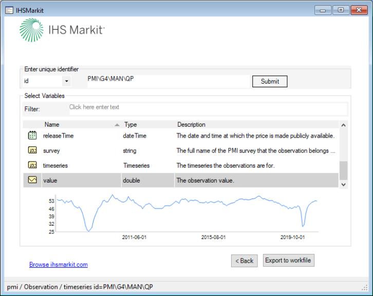

EViews offers a custom interface to IHSMarkit data. To open the database, select File/Open Database… from the main EViews menu, then select IHSMarkit from the Database/File type dropdown menu:
You are required to enter Username and Password information before you click on OK. EViews will verify your user information and open a standard database window:

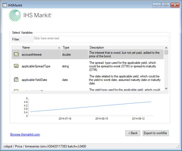

Click on Browse to open the custom IHSMarkit window:
The dialog allows you to select data available within datasets using the Namespace field. You may also search through the datasets by typing a keyword in the Filter textbox. For this example, select a dataset and click the Next button:
Select the type of identifier (id, cusip, isin, etc.) you want to use in the drop-down box. Type or paste a unique id and click the Submit button:
The dialog interface will display the list of variable names, their types, and a description. Type a keyword in the Filter textbox to filter the results. The interface also provides a graph preview of the series data selected. Once you have found and selected the series of interest, you may drag-and-drop or click the Export to workfile button to export the series directly into a new or preexisting EViews workfile.
We may go back to the top level and select the Corporate and Sovereign Bonds Pricing Data. The pricing data is organized into batches:
When batch information is available, after a unique id is entered the results table will show a list of batch-ids and metadata information. Type a keyword in the Filter textbox to filter the results.
Note that in the example shown in the dialog above, there are four tabs/buttons (Price, Instrument, Organization, TraceStatistics). The IHSMarkit API identifies these as Entities and they represent additional categories with uniquely identified records. In the above example we have selected Price (the Entity Price defines the price, yield, spreads and other metrics of an instrument.).
Select a batch id and click the Next button:
The dialog interface will display the list of variable names, types, and descriptions. Type a keyword in the Filter textbox to filter the results. The interface also provides a graph preview of the series data selected. Once you have found and selected the series of interest, you may drag-and-drop or click the Export to workfile button to export the series directly into a new or preexisting EViews workfile.
All of the IHSMarkit Edx dialogs contain a link (Browse ihsmarkit.com) to the API. Click on the link to get additional information, including documentation.

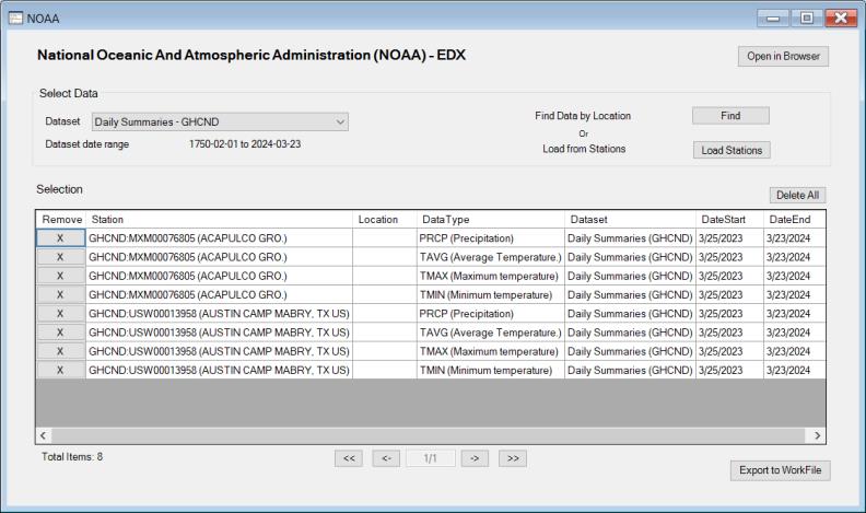

The National Oceanic and Atmospheric Administration (NOAA) offers an extensive range of publicly available weather and climate datasets. For further details on NOAA data offerings, refer to:
https://www.ncdc.noaa.gov/cdo-web/webservices/v2#datasets
EViews 14 offers an all new interface that enables users to interact with EViews while simultaneously searching for data through the EDX dialog. This new NOAA database dialog includes a user-friendly table where all selected entries for import are recorded, facilitating the direct importation into a workfile. This process significantly enhances user workflow and efficiency, providing a seamless experience for data retrieval and integration into EViews.
To access the NOAA database, choose File/Open Database from the main EViews menu, and then select National Oceanic and Atmospheric Administration from the Database/File type drop down menu.
When opening the NOAA database for the first time, you'll be asked to enter an API Key obtained from the National Oceanic and Atmospheric Administration.
To request an API Key visit: https://www.ncdc.noaa.gov/cdo-web/token.
Enter your API key and click OK. The key will be saved as a user specific setting in your EViews “.ini” file. If you need to change the key later, select View/Preferences from the EViews database menu to modify your settings.
When you click on OK, EViews will open a standard database window.

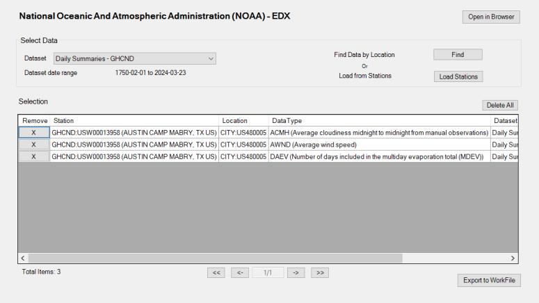

Click on Browse to open the custom NOAA window:
This custom interface will allow us to drill down through dataset, location, data type, and station selection to specify the data of interest.
When you first display this dialog, the Selection area will be empty.
To select the data, first specify a dataset using the Dataset drop down menu.
You may then choose to Find Data by Location by clicking on the Find button to select one or more locations from a list, or you elect to Load from Stations by clicking on the Load Stations button to specify stations using Station IDs.
Find Data By Location

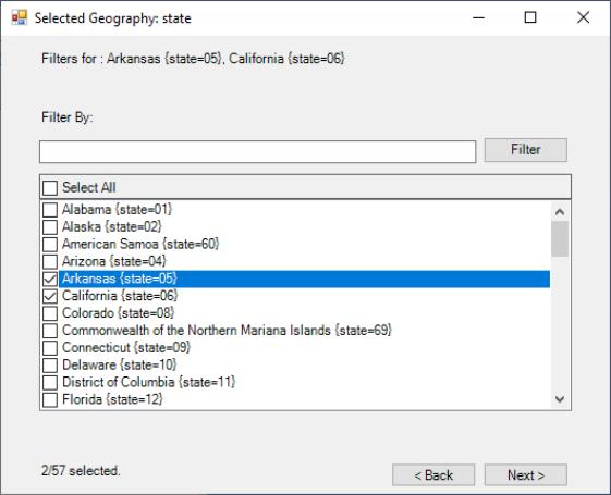

If you choose click on the Find button to Find Data by Location, a dialog will be displayed to walk you through the selection process:

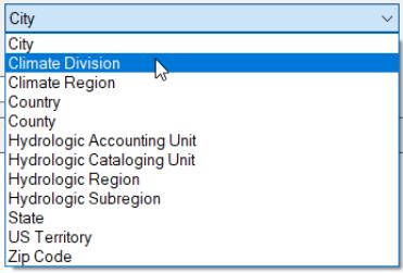

The drop down menu at the top should be used to specify a Location Category to browse:
You may choose from a variety of location categories including, for example, City, Climate Region, County, Hydrologic Region, and Zip Code.
You can filter the displayed list of locations using a text string by entering the text in the Filter by edit field, and clicking on the Filter button.
Select the desired locations from the list and click Next to continue.

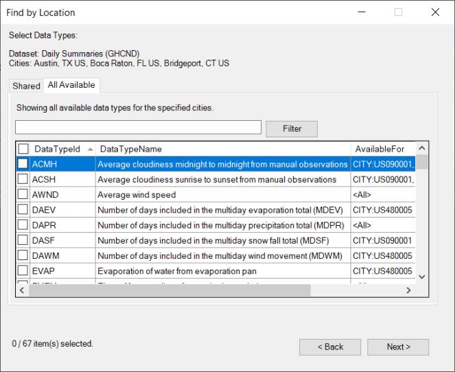

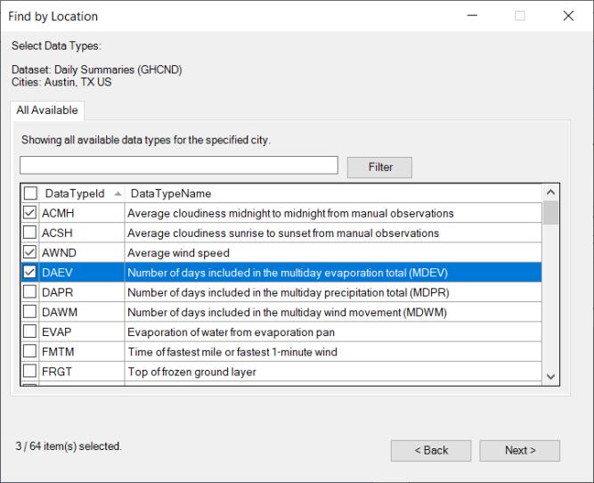

If you select a single location, you will see a dialog prompting you to select specific data types for the selected location:
You may use the filter to pare the list if desired. Click to select and deselect the entries.
If you selected multiple locations in the location step, a EViews will display a dialog with two tabs: a Shared tab showing data types common to all of the locations, and an All Available tab listing all available data types across all of the locations.
Use the Filter edit field and button to refine your search in the lists on both tabs, select the data types of interest, and click Next to view the available NOAA stations.

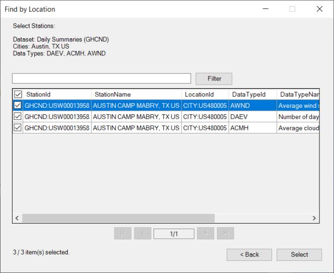

In the next dialog, you will find the available stations that match the selected data types and locations.
Choose the desired stations from which you want get data and the click Select.

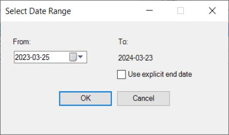

You will be asked to select a date range in order to limit the data results. NOAA restricts requests for annual and monthly data to a ten-year range; all other frequencies are restricted to a one-year range.
Click on OK to continue and display the main NOAA dialog:
You will see in the Selection table the data you have just selected from your search. You can directly export these data to a workfile or find additional data before proceeding with the export.

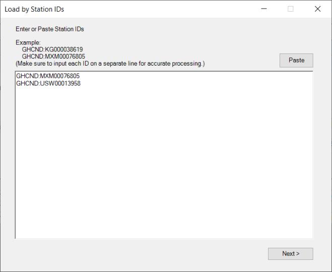

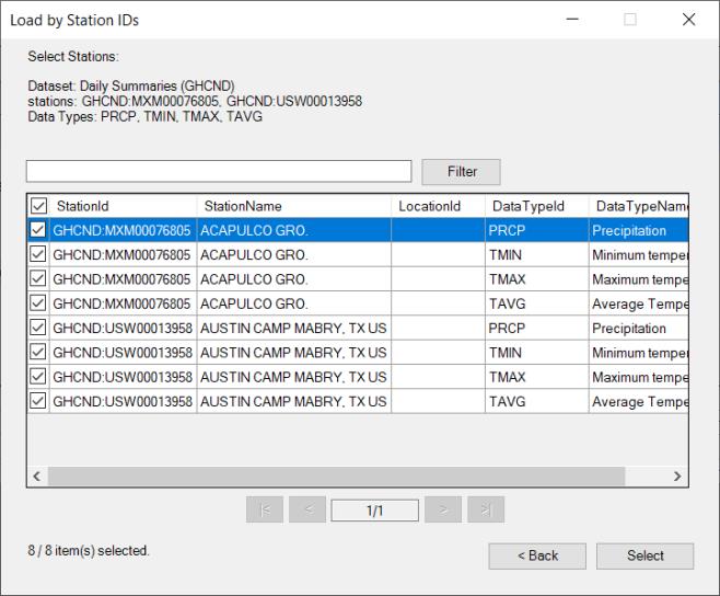

Locations From Stations
If you select Load Stations, instead of Find by Location, the displayed dialog will contain a textbox where you can manually type or paste from the clipboard the station IDs from which you want to retrieve data:
Click on Next to continue.

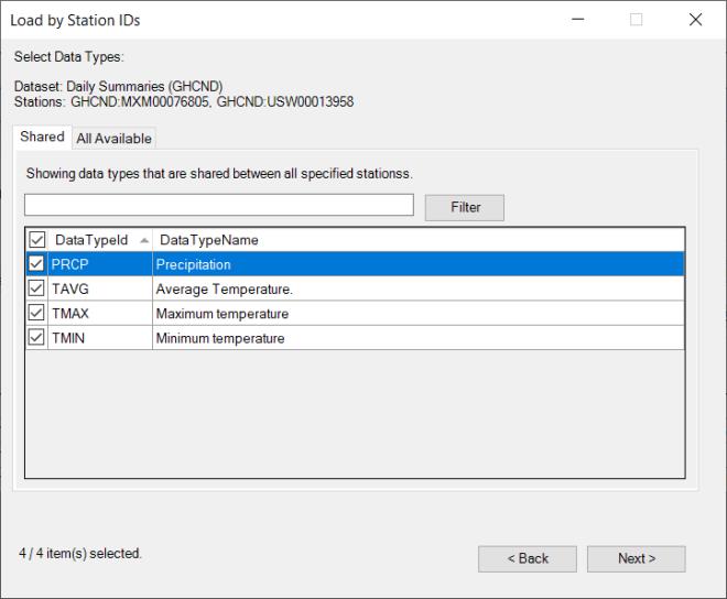

The next dialog will prompt you to select the data types. Once again, the dialog will feature one tab if there is a single location, or two tabs, a Shared tab for data types common to all of the locations, and an All Available tab for available data types across all of the locations.
Select the desired data types and click Next to display the next dialog where you will to select station and data type combinations:
Click on Select to continue to the final dialog where you will choose the date range:
As before, note that NOAA restricts requests for annual and monthly data to a ten-year range; all other frequencies are restricted to a one-year range.
Click the Export to WorkFile button to export the chosen data to either an existing or a new workfile.

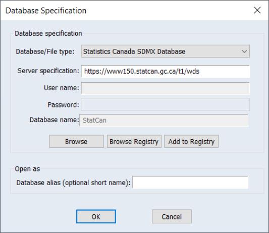

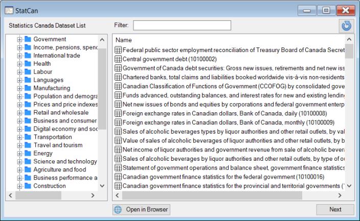

To begin, open the database windows by selecting File/Open Database from the primary EViews menu, select Statistics Canada SDMX Database from the Database/File type drop down menu,

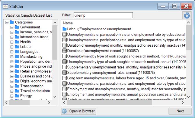

Click on OK to proceed and open the data browser

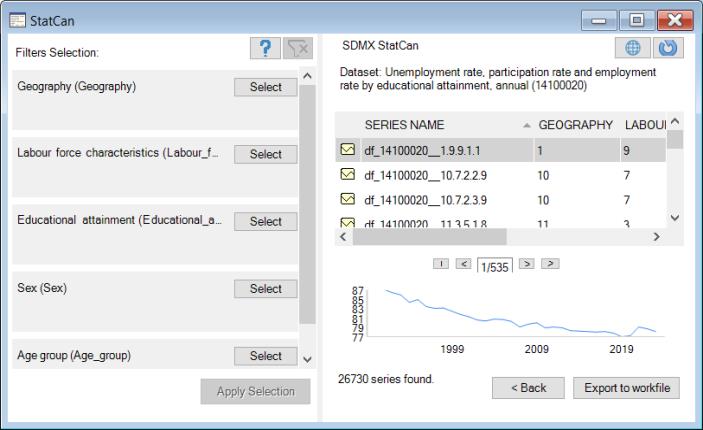

The left-hand side of the data browser offers tree interface through which may navigate until you locate the desired dataset.
Alternately, you may use the Filter edit box to input a keyword, enabling a search across all categories and datasets.
Once you locate the desired dataset, you can either double-click on the dataset in the list on the right section or select it and then click Next to display the filter page.
Note that the StatCan SDMX databases offers a data browser on their official website that allows you to search for a dataset. Click on the Open in Browser button, which will open a web browser window showing the official database website.
To enhance the performance of the data explorer interface, categorization information is cached when the interface is first loaded. While a remote possibility, the database information may be updated during your EViews session. To refresh the cache, you may click on circular arrow Refresh button in the upper-right hand portion of the dialog.
You may use the filter page to refine your search. See “Selecting Series” for additional detail. Once you have the data series desired, you may click on Export to workfile to download the data into an EViews workfile.

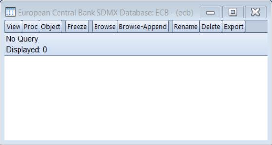

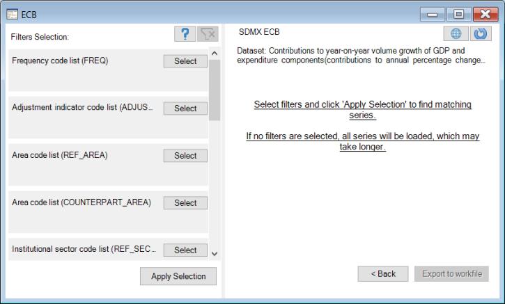

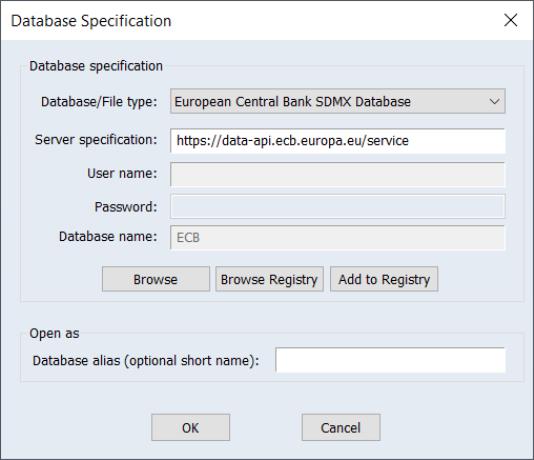

To begin, open the database windows by selecting File/Open Database from the primary EViews menu, select the desired SDMX database from the Database/File type drop down menu,
and click on OK to continue.
EViews displays the standard database dialog, indicating that you have an active connection to the data.
Click on Browse or Browse-Append to open the database.
Selecting a Database
Categorized Datasets
Non-Categorized Datasets

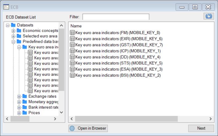

EViews offers one of two different interfaces for selecting a SDMX database: a tree structure navigator and filter for databases that offer dataset categorization information, and a simple scroll and filter interface for databases without categorization information.

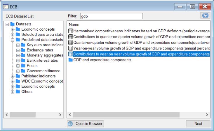

If the SDMX database offers categorized datasets, the dialog interface offers features that facilitate dataset exploration through a nested tree structure.
The tree interface makes it easy to select or search for a specific category and then navigate through the nested tree until you locate the desired dataset. Simply use the tree structure on the left-hand pane to drill down to the desired subcategory, clicking on the node indicators as needed to inspect the contents. You may also double click on folders displayed in the right-hand pane to show its contents.
Alternatively, you can use the Filter edit box to input a keyword, enabling a search across all categories and datasets.
Once you locate the desired dataset, you can either double-click on the dataset in the list on the right section or select it and then click Next.
Some SDMX databases offer a data browser on their official website that allows you to perform more advanced search. Click on the Open in Browser button, which will open a web browser window showing the official database website.
To enhance the performance of the data explorer interface, categorization information is cached when the SDMX interface is first loaded. While a remote possibility, the database information may be updated during your EViews session. To refresh the cache, you may click on circular arrow Refresh button in the upper-right hand portion of the dialog.
Alternatively, for SDMX databases that do not offer categorization information, the dialog interface simply offers a list of the available databases:
You can type a keyword in the Filter edit field to find a dataset. Select the dataset and click Next to continue.
Selecting Series

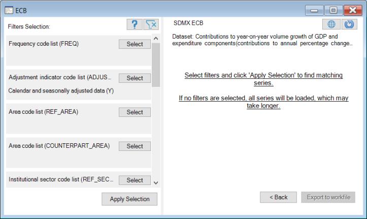

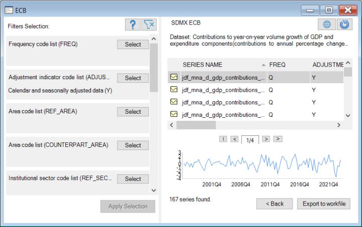

In this dialog, you will choose the series to import:
We begin by forming a list of potentially relevant series. By default, all of the series in the dataset will be in the list. If available, you may use filters on the left-hand side of the dialog to reduce the number of series to be read. To specify a filter, click on the Select button on the left-hand side of the dialog corresponding to a specific category. You will be presented with a dialog showing the possible filter elements:
Click on the filter element entry to toggle the selection. You may use the Search button to locate a specific filter entry.
Here we use the Adjustment indicator code list to require data to be calendar and seasonally adjusted data:
Once the filter definition for the category is complete, click Save to save the filter settings and return the main selection dialog.
The dialog lists any relevant filter elements in text form under the name of the filter. If the information is not fully legible, you may hover your cursor over the text to see the full specification.
Once you finish defining any selection filters, click on the Apply Selection button to load a list of the relevant series in the dataset:
Here, there are 167 series found in the dataset that match the current filter. Click on any of the entries on the right to display information about the individual series and to display a thumbnail graph of the series.
You may go back and specify additional filters and click on the Apply button to update the list of relevant series.
Finally, you may select one or more series in the list, then click on the Export to workfile button to load the selected series into a new or existing workfile.
Note that the Refresh Data button in the upper-right corner may be used to ensure the database information is up-to-date. For some databases, there will also be an Open in Browser button which will take you to the selected dataset on the database website if available. This feature is applicable only to those databases that offer an online data browser.

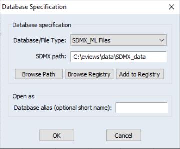

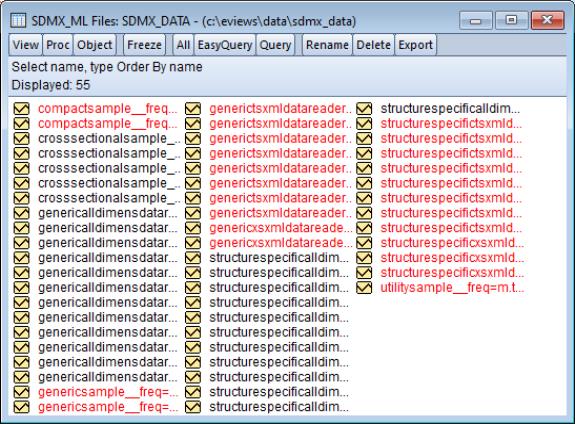

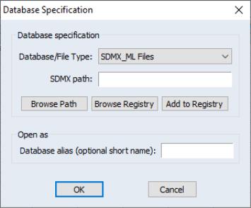

To start, you must open a database window to SDMX-ML by selecting File/Open Database… from the main EViews menus, then selecting SDMX-ML files from the Database/File type dropdown menu. The following dialog should appear:
Click on Browse Path to select the folder/path on disk where the SDMX data and data definitions files are located.
Click on OK to open the database. You will be presented with a standard EViews database with the All, Query and Easy Query search interface, to view all or a selection of the data series:

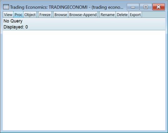

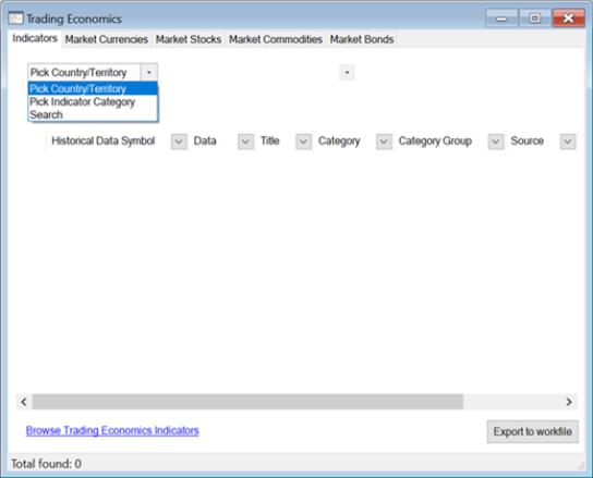

EViews offers a custom interface to Trading Economics data. To open the database, select File/Open Database… from the main EViews menu and select Trading Economics from the Database/File type dropdown menu:
Click OK to open the standard EViews database window:

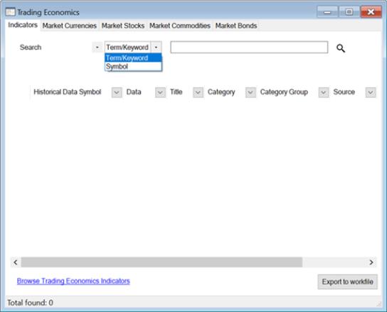

Click on Browse in the toolbar to open the custom Trading Economics window:

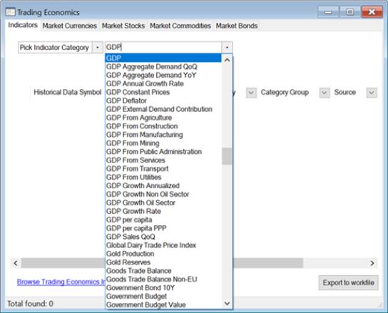

The dialog interface displays five tabs, or categories, of data: Indicators, Market Currencies, Market Stocks, Market Commodities, and Market Bonds.
Indicators
Under the Indicators tab, choose between picking a country/territory, an indicator category, or a search:
For Pick Country/Territory, select a country from the drop-down box to see historical and forecast indicators:
For Pick Indicator Category, select a category from the drop-down box to see historical and forecast indicators:
For Search, select Term/Keyword or Symbol and enter an expression in the text box:
The user interface provides a way to filter through the results regardless of the method chosen. After picking the country Mexico, for example, the dialog displays a table with the indicator results:
Click the drop-down box next to each column header to show a set of filter checkboxes. Select one or more of these to display selected values or select All to show all values. Click Reset Filter to clear all filters.

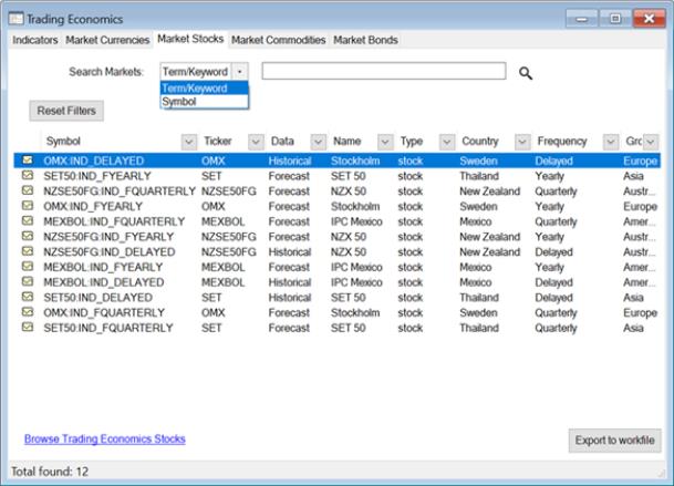

If any of the market tabs (Market Currencies, Market Stocks, Market Commodities, Market Bonds) are selected, the dialog will display a table with all the stock market symbol results you have permission to see based on your subscription. For example, the below dialog shows the Market Stocks tab:
You may elect to search for a Term/Keyword or a Symbol. Once the series of interest is found and selected, drag-and-drop or click the Export to workfile button to export the series directly into a new or existing workfile.
For more information click the Browse Trading Economics Stocks link at the bottom of the dialog to open the Trading Economics webpage.

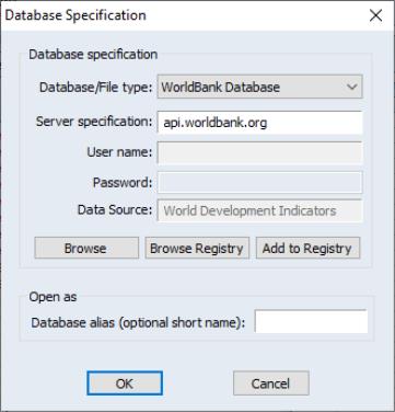

EViews offers a custom interface to World Bank data. World Bank Open Data provides access to a list of datasets that offer access to global development data. These databases offer a wide variety of freely downloadable indicators about development in countries around the world.
For more information on the World Bank datasets, please see http://data.worldbank.org.
Please note that an internet connection will be required to obtain World Bank data.

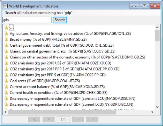

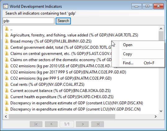

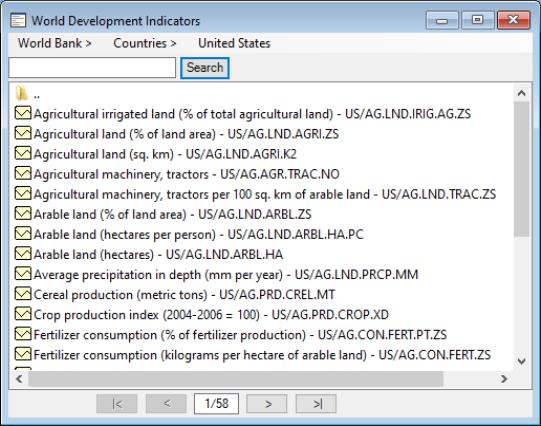

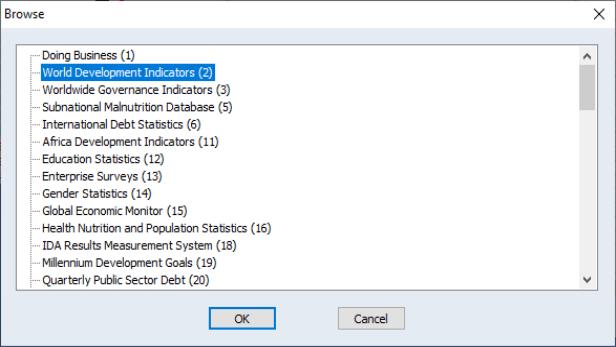

EViews offers a custom interface to the World Bank. The interface includes a browser for navigating and retrieval of World Bank data. To start, you will open a database window by selecting File/Open Database… from the main EViews menus, then selecting World Bank Database from the Database/File type dropdown menu. The following dialog should appear:
The default Data Source selected is World Development Indicators (a collection of development indicators that includes global development data). Click on Browse to view and select another data source.
Click on OK to open the online database. You will be presented with a standard EViews database window.
The database window represents a connection to the data. Click on Browse or Browse-Append, which opens a new custom World Bank database. Click on the folder icons to move down into subtopics:
The browser allows you to find data available within the World Bank by navigating through a set of nested folders. Simply click on any folder to move inside it.
The full path of the active folder will be shown in the header at the top of the window. You can click on any folder within the path to navigate back to that folder. Here, clicking on Countries will move back up a single level to show the country choices. Similarly, clicking on the ".." in the window listing will move up a single level.
The browser interface to the World Bank offers a number of useful tools for working with your World Bank database:
• The Search button allows searching by keyword. Simply enter a keyword into the edit box and click the Search button. EViews will display a list of indicators that match the keyword.
• You can use the < and > buttons to navigate to the next and the previous indicator pages.
• You can use the |< and >| buttons to navigate to the first or last indicator pages.
1. Right-click Open can be used to navigate inside a folder or bring an indicator in the database window.
2. Right-click Copy can be used to select an indicator to be copied to a workfile
3. Right-click Find allows you to do a keyword search.

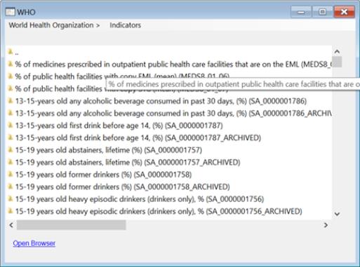

World Health Organization (WHO) provides access to a large range of health-related data and statistics. An internet connection is required to obtain WHO online data.
The WHO database interface is not available in EViews Standard Edition.
For more information on data subscriptions, please see:
https://www.who.int/data/gho

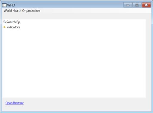

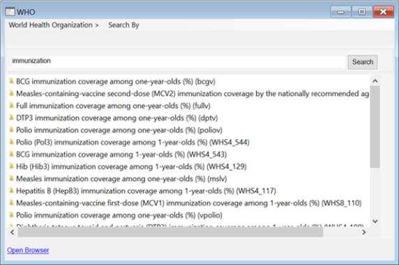

EViews offers a custom interface to World Health Organization data. To open the database, select File/Open Database… from the main EViews menu and select World Health Organization from the Database/File type dropdown menu:
Click on Browse in the toolbar to open the custom WHO window:
Click on the Indicators folder and navigate through the set of nested folders:
Click on a folder to open its subtopics:
The full path of the active folder is shown in the header. Click on any folder within the path to return to it. For example, clicking on By country will move up a single level to show the country choices. Similarly, clicking on “..” in the window listing will move up a single level.
Alternately, click on Search By to search for a keyword:
Once the series of interest is selected, drag or copy it into a workfile. For more information, click the Open Browser link at the bottom of the dialog to open the WHO website.
