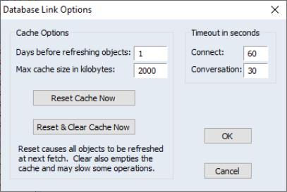

You can regulate the caching behavior of the database link in a number of different ways. The basic option which determines under what circumstances a new copy of the data should be fetched is the days before refresh. If you attempt to fetch an object from the database link, and the copy of the object currently in the cache was fetched more recently than the days before refresh value, then the object currently in the cache will be returned instead of a fresh copy being fetched. For example, if days before refresh is set to one, any object which has already been fetched today will be retrieved from the cache, while any object which has not yet been fetched today will be retrieved from the remote site. Similarly, if days before refresh is set to seven, then an object in the cache must be more than a week old before a new copy of the object will be fetched. If days before refresh is set to zero, then a new copy of the data is fetched every time it is used.
You can change the days before refresh setting by clicking on the button at the top of the database link window, then choosing from the pop-up menu. A dialog will appear:
The dialog contains a number of fields, one of which is labeled Days before refreshing objects. Type a new number in the field to change the value.
The same dialog also contains a button marked Reset cache now. This button can be used to modify the behavior documented above. Clicking on the button causes the cache to mark all objects in the cache as out of date, so that the next time each object is fetched, it is guaranteed that a fresh copy will be retrieved. This provides a simple way for you to be certain that the database link will not return any data fetched before a particular time.
The dialog also contains some options for managing the size of the cache. The field marked Maximum cache size in kilobytes can be used to set the maximum size that the cache will be allowed to grow to on disk. If the cache grows above this size, a prompt will appear warning you that the cache has exceeded the limit and asking if you would like to compact the cache. Compacting is performed by deleting objects from oldest to newest until the cache size is reduced to less than three quarters of its maximum size. The cache is then packed to reclaim the empty space.
You can also completely clear the contents of the cache at any time by clicking on the button marked Reset & Clear Cache Now.
You can always examine the current contents of the database cache by clicking on the Cache button at the top of the database link window. This will display the names of all objects currently in the cache.
Configuring Link Options
The dialog also allows you to specify a number of timeout values. In most cases, the default values will behave acceptably. If you believe you are having problems with EViews aborting the connection too early, or you would like to shorten the times so as to receive a timeout message sooner, then enter new values in the appropriate fields.
• Connection timeout—is the length of time, in seconds, that EViews will wait for a response when first connecting to DRI. Depending on the type of connection you are making to DRI, this can take a significant amount of time.
• Conversation timeout—is the length of time, in seconds, that EViews will wait for a response from DRIPro when carrying out a transaction after a connection has already been made.
The values are attached to a particular database link, and can be reset at any time.
