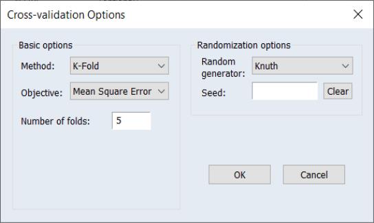

K-Fold
In K-fold cross-validation, the dataset is randomly divided into (roughly) evenly sized groups (“folds”). One fold is held out as the test set while the remaining folds are combined into a training set. The model is estimated (“trained”) using the training set and the selection statistic is computed using the observations in the corresponding test set. This training and test step is repeated, with each fold acting as the test set. The selection statistics are averaged over the values to obtain a final value.
The number of folds is specified in the Number of folds edit field.
The randomization procedure is governed by the specified Random generator and the random Seed fields. You may the leave the Seed field blank, in which case EViews will use the clock to obtain a seed at the time of estimation, or you may provide an integer from 0 to 2,147,483,647.

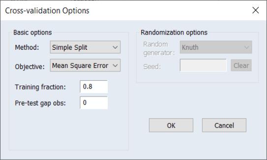

Simple Split
In simple split cross-validation, the dataset is divided into a training and test set. A pre-test gap allows for additional separation (oftentimes temporal) between the training and the corresponding test samples.
The model is estimated for the observation in the training set and the selection statistic is computed using the test set.
The simple split method is parameterized using the Training fraction parameter , where the training set is the first set of observations, the Pre-test gap obs of , and the test set is comprised of the remaining observations.

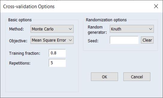

Monte Carlo
Monte Carlo cross-validation repeatedly splits the sample into a random training set of observations, and a test set containing the remaining observations.
Monte Carlo cross-validation can be thought of as a repeated simple split computation on randomly ordered data. Estimation and evaluation of the selection statistic are computed using each of the training and corresponding test sets, and the results are averaged to obtain a final selection statistic value.
The training/test split is parameterized using the Training faction parameter . The number of Monte Carlo random splits is specified in the Repetitions edit field.

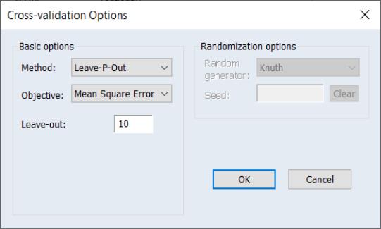

Leave-P-Out
In Leave-P-Out cross-validation, observations are held out as a test set, and the remaining observations are combined into a training set. This procedure is repeated for all distinct sets of observations in the original sample. The resulting statistics are averaged to obtain a final selection statistic value.
Since the number of models to estimate increases combinatorially with the sample size, Leave-P-Out cross-validation is typically employed in settings with relatively small numbers of observations. We strongly urge caution in using this method even with moderate numbers of observations and .
The number of leave-out observations is specified in the Leave-out edit field.

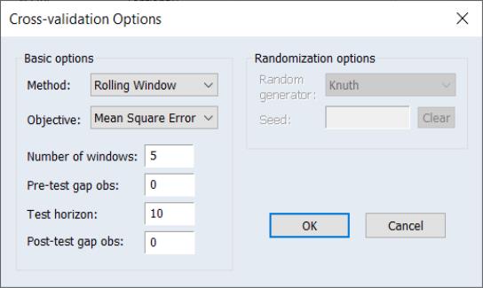

Rolling Window
The Rolling Window cross-validation method is a time-series oriented approach in which the full sample is divided into non-overlapping windows, and each window in turn divided into a training sample, followed by pre-test gap and a fixed number of test sample observations.
Central to this rolling window approach is a maintaining of all temporal relationships, with all observations ordered sequentially with respect to time, and with the test sample following the training sample.
The pre-test gap allows for additional temporal separation between the training and the corresponding test samples, and the post-test gap provides separation between a test sample and the subsequent training sample.
To specify your settings, fill in the Number of Windows edit field, then specify the number of Pre-test gap obs and Post-test gap obs, and enter the test sample size in the Test horizon edit field. The size of the training samples will be determined from the number of observations and the remaining settings.

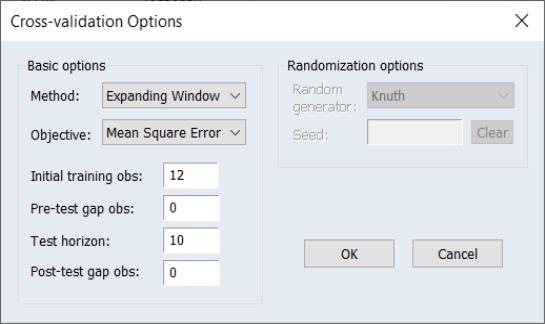

Expanding Window
The Expanding Window cross-validation method is a time-series oriented approach in which we start with an initial training sample, a pre-test gap, and a fixed number of observations in a test sample.
Subsequent cross-validation samples are obtained by expanding the training sample to include the previous employed observations along with a post-test gap, and repeating the training and test procedures.
All temporal relationships are maintained with this approach, with all observations ordered sequentially with respect to time, and with the test sample following the training sample.
You should enter the size of the initial training sample in the Initial training obs edit field, then specify the number of Pre-test gap obs and Post-test gap obs, and enter the test sample size in the Test horizon edit field.
