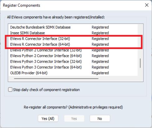

Verify that the new EViews R Connector Interface components are properly registered by running the EViews command REGCOMPONENTS:
In the Register Components dialog, make sure that the EViews R Connector Interface objects have been properly registered. If not, click the button to re-register these components on your local machine, then re-run REGCOMPONENTS to verify the registration. Note: Registration of these components will require local administrator rights. If you do not have these admin rights, please contact your IT department for support.

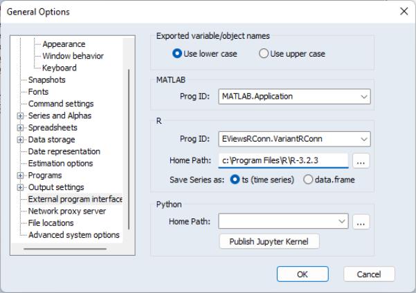

Next, go to the External Program Interface dialog under the :
In COM ProgID group, make sure that EViewsRConn.VariantRConn is selected for R.
Next, if is blank, click the […] button and navigate to your local R installation. Select the version-specific R folder (e.g., “R-3.2.3”) under the parent R folder as your home directory.
Optionally, you can also select your as preference when pushing EViews series objects into R. If you select “ts (time series)”, series objects that have a compatible R ts frequency will be pushed as R ts objects. Otherwise, an R data.frame structure will be created instead.

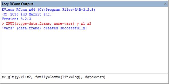

XOPEN(type=r)
This will begin a new session of R and, by default, an associated RConn Output log window should appear. This log window will show any R commands we run and any output generated by R. You can also type R commands interactively into the RConn log window.
Now that we have an open connection to R, we can use the other 'X' methods to perform some actions.
Sending EViews Data to R
Now that we have an open connection to R, we can send EViews object(s) to R using the XPUT command:
XPUT(rtype=data.frame, name=vars) y x1 x2
Basic EViews object types such as series, alphas, matrices, vectors, and scalars can be pushed successfully to R. Depending on the EViews object type, an appropriate R object will be created when the data is sent. As our example shows, XPUT also supports grouping multiple series objects into a single R time series or R data.frame object.
Running an R Command
Now that we have some data in R, we can run R specific commands by using the XRUN command:
XRUN z<-glm(y~x1+x2, family=Gamma(link=log), data=vars)
You can also type this command directly into the bottom of the RConn log window (without XRUN):

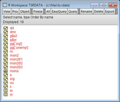

In EViews 13, you can now open an RDATA workspace file as an EViews Database:
DBOPEN(type=rdata) c:\files\data.rdata
This will open the RDATA file in its own EViews database window. You can view all the R objects found in this database and individually FETCH the objects you want into your workfile:
Note: R data structures that could have multiple columns/elements (such as data.frame, list, and mts objects) are listed once per column/element with the appropriate R name.
As an EViews Database, you can use both FETCH and STORE to read and write data to the RDATA file and even link EViews series objects back to their source R structure to allow for simple data refreshes.
