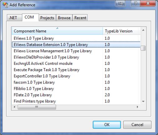

More precisely, EDX is a set of COM interfaces. Supporting a new format involves creating a small library (usually housed in a DLL) that contains COM objects that implement these interfaces. The library can be developed in many different programming environments including native C++ and Microsoft .NET. These COM objects are used by EViews to interact with the underlying database.
