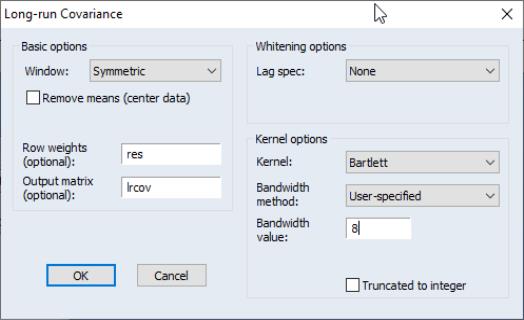

Next, we will compute the symmetric long-run covariance of . Double click on XVARS to open the group containing the regressors, then select View/Long-run Covariance... to display the dialog.
We must make a few changes to the default settings. To weight the regressors using the residuals, you must enter “RES” in the Row weights edit field. Uncheck the Remove means checkbox, since the should already have mean zero. Then, enter “LRCOV” in the Output matrix edit fields so that EViews will save the results in a sym matrix object.
The Stock-Watson example uses a Bartlett kernel with no pre-whitening, so we leave the Lag spec at the default None setting and the Kernel shape choice at the default Bartlett. We should, however, change the Bandwidth method to User-specified and enter “8” in the edit field to match the 7 lags employed by Stock and Watson. Click on OK to compute and save the results.
