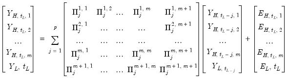

Stacking the and variables into the matrices and , respectively, and for brevity ignoring the intercepts and exogenous variables, we may write the VAR as:
(49.1)
where is , is , and is , for all , , and is .
The U-MIDAS approach constructs these data and simply uses classical VAR least squares to estimate , the stacked matrix of coefficients.
