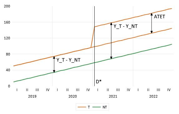

To estimate the average impact of the treatment on Y, we compare the difference in the mean of Y between the treated and never treated groups before and after the treatment date:
| (55.1) |
which we term the Average Treatment Effect for the Treated (ATET).
The ATET may be visualized as:

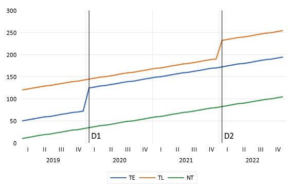

A natural extension to the single treatment model is to assume that different groups of individuals have different treatment dates:
Here we have 3 groups of individuals, some are never treated
NT, some are treated at the earlier date
TE), and some are treated at a later date
TL).
In such cases we are still interested in the average treatment effect for the treated (ATET), where the treatment effect is calculated as the effect on the trend post-treatment, whenever that treatment occurs.
