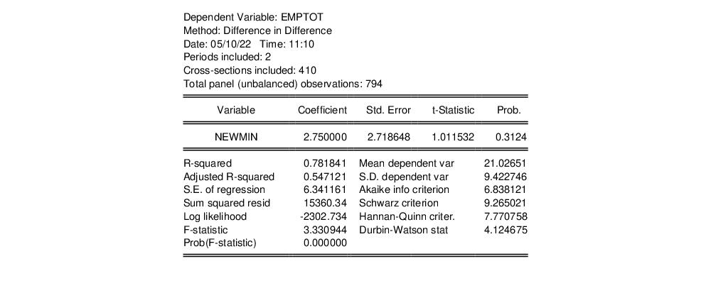

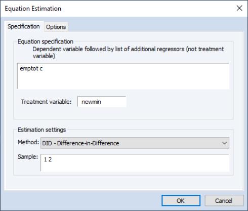

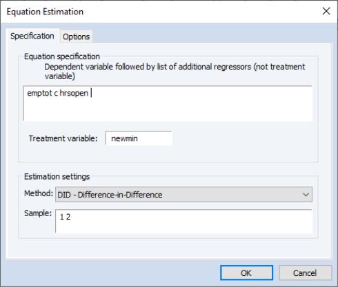

We can replicate one of the results in the Card and Krueger paper by performing a simple difference-in-difference estimation of EMPTOT against NEWMIN. We click on Quick/Estimate Equation and then select DiD – Difference-in-Difference from the Method dropdown to display the dialog:
Enter “EMPTOT C” in the Equation specification edit field, the name of the treatment indicator “NEWMIN” in the Treatment variable edit field, and “1 2” in the Sample edit field. Click on OK to estimate this specification. EViews will display the estimation results:
The estimate of the impact of the increase in the minimum wage on employment is 2.75. This matches the result in Row 4., column (iii) of Table 3 in Card and Krueger, and forms part of the basis for their overall finding that raising the minimum wage in New Jersey actually led to an increase in employment.

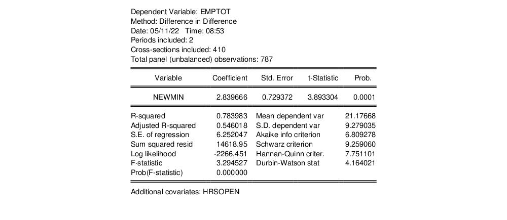

We could extend the specification to include the number of hours a store is open as a covariate, simply by entering “HRSOPEN” as a regressor in the Equation specification edit field:
Although not a specification estimated by Card and Krueger, estimation results for the extended model allow evaluation of whether the basic result is sensitive to inclusion of this covariate.
Click on OK to estimate the expanded specification. The results are given by:
We can see that the inclusion of the HRSOPEN covariate (which is indicated at the bottom of the output) did not have a large impact on the estimate of the effect of the minimum wage increase (2.84 compared with the original 2.75), though the statistical significance of the result is enhanced considerably.

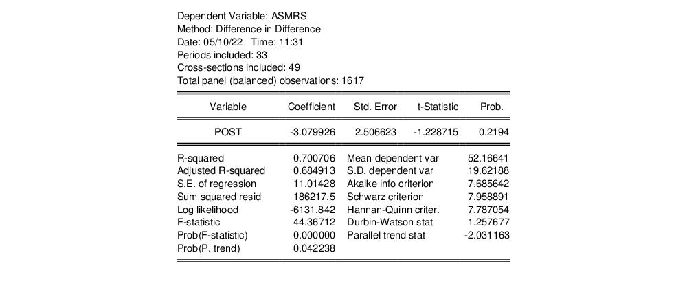

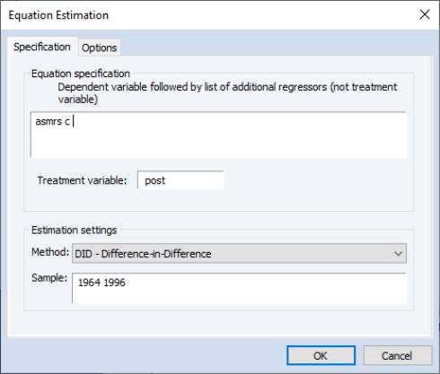

To determine the impact of no-fault divorce reform on female suicide mortality rate we can perform a simple difference-in-difference, with multiple timings, estimation. We click on Quick/Estimate Equation and then change the Method dropdown to DiD – Difference-in-Difference. Note this method is only available because we have a workfile structured as a panel. We enter “ASMRS” as the dependent/outcome variable, followed by our treatment dummy, “POST”, and the sample pair “1964 1996”:
Clicking OK produces the estimation output:
The estimate of the impact of no-fault divorce reform on suicide mortality in females is -3.08, which matches the number presented in Section III of Goodman-Bacon (2021).

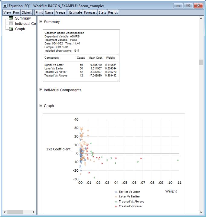

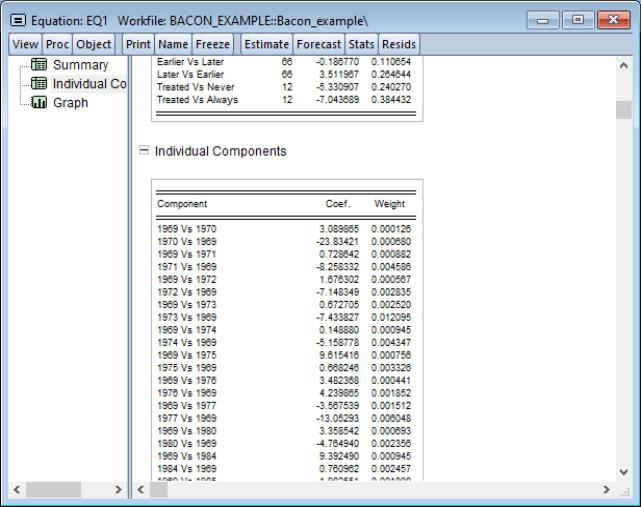

To view the Goodman-Bacon decomposition ( “Goodman-Bacon Decomposition”) we click on View/Difference-in-Difference Diagnostics/Goodman-Bacon Decomposition:
EViews opens a spool with output divided into three sections. The Individual components middle section showing all of the individual coefficients and weights for each pair of treatment dates is closed by default. These individual results can be displayed by clicking the “+” symbol:
We can see that the coefficient comparing observations that introduced divorce reform in 1969 with those that introduced reform in 1970 is 3.09.
The weighted average of these individual year pair-comparisons, combined into groups, is displayed in the first section. We can see that each of the groupings has a negative coefficient, apart from the “Later vs. Earlier” group. Since this comparison group may violate the parallel trends assumption, it is possible that a biased positive coefficient with large weight may have upwardly biased the overall TWFE coefficient to the reported value of -3.08.
We can see that there is a large number of the “Later vs. Earlier” group above the overall estimated coefficient, again indicating that this group may be upwardly biasing the overall estimate.

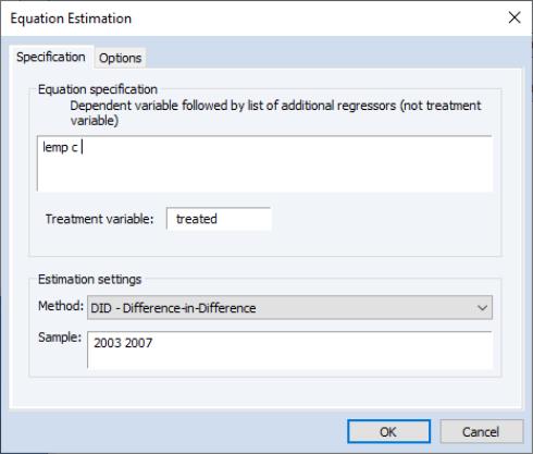

These data are provided in the workfile “CallawaySantanna.wf1”. The series TREATED is a binary variable indicating whether a county has been subject to an increased minimum wage in the time period, the series LEMP contains the log of employment for that county in that time period, and the series LPOP contains the log of the population within the county. A TWFE estimation of the impact of minimum wage on employment can be performed by clicking on Quick/Estimate Equation and then changing the Method dropdown to DiD ‑ Difference-in-Difference. We enter “LEMP” as the dependent/outcome variable, followed by our treatment dummy, “TREATED”, and sample pair “2003 2007”:

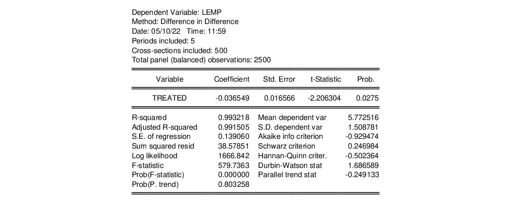

Click on OK to estimate the specification:
Note the TWFE estimate of the impact of treatment matches that given in Callaway and Sant’Anna, Table 3, section A.

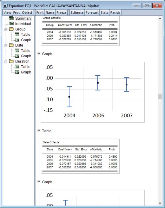

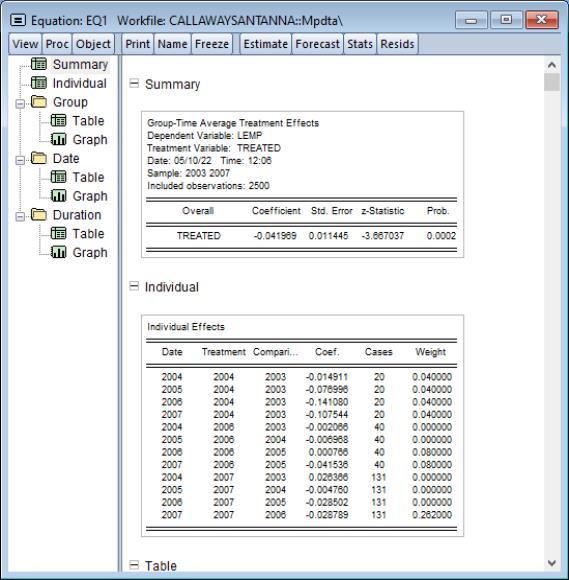

To view the Callaway-Sant’Anna estimator we click on View/Difference-in-Difference Diagnostics/CS Group-Time Effects… which brings up the Callaway-Sant’Anna dialog:

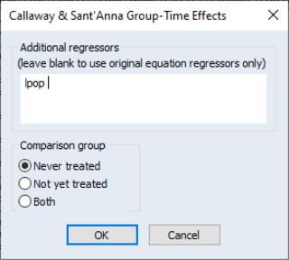

Note, we’ll include an additional regressor, LPOP, and set the comparison group to by those states who never perform divorce reform. Since county population is constant through the time period being analyzed (population data is taken from the 10 year census), it would not be possible to include it as an explanatory variable in TWFE estimation. However, it may be used in the CS estimator.
The top portion of the output displays the overall estimate of the treatment effect, -0.042, which compares with the TWFE estimate of -0.37.
Below this section we can see the individual coefficients for each date pairing, as well as aggregations of them by treatment date (Group), observation date (Date) and time-since-treatment (Duration).
