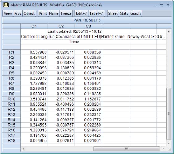

There is little difference between the settings for long-run covariances and variances in non-panel and panel settings. You may, however, provide a name in the Panel matrix edit field to EViews to save a matrix containing the individual covariance estimates. Each row will contain the vec or vech of the results matrix for the corresponding cross-section.

and the individual cross-section results are stored in the matrix PAN_RESULTS, with the vech of the individual cross-section covariances stored in each row:
