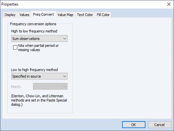

In dated workfiles, the Freq Conversion tab will also be displayed. You may use this tab to set the default frequency conversion settings for the series. Recall that when you fetch a series from an EViews database or when you copy a series to a workfile or workfile page with a different frequency, the series will automatically be converted to the frequency of the destination workfile. The conversion options view allows you to set the method that will be used to perform these conversions (see “Reading EViews Data using Other Applications”).
Each series has a default up and down frequency conversion method. By default, the series will take its settings from the EViews global options (see “Frequency Conversion”. This default series setting is labeled EViews default. You may, of course, override these settings for a given series. Here, instead of using the global defaults, the high to low conversion method is set to Sum observations without propagating NAs.
