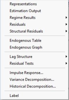

Once you have estimated your VAR, EViews offers a variety of views for examining your results.
Most of these routines are familiar tools for working with an estimated VAR. You may, for example, examine Residuals or Structural Residuals views for your estimated VAR, examine the Impulse Response... or Historical Decomposition... views or examine the Lag Structure of your VAR.
Since the presence of multiple regimes creates a few wrinkles, we offer a few comments on select views.

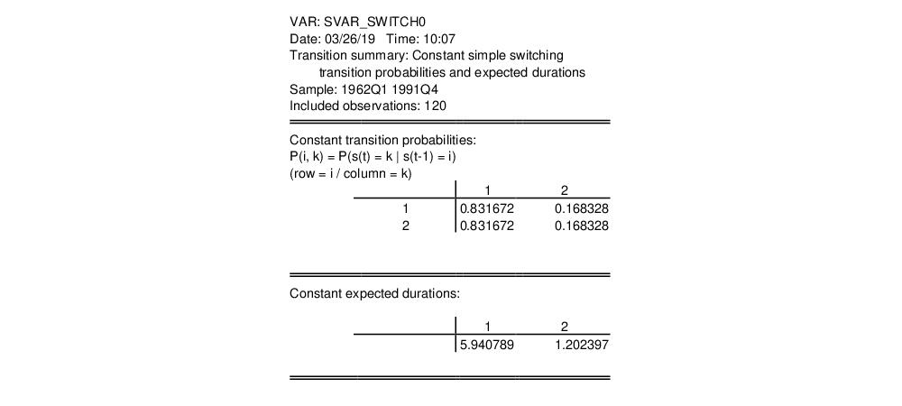

The default Summary display shows a table containing both the transition matrix and the expected durations (Kim and Nelson, 1999, p. 71-72) implied by the transition matrix. For example:
Here, we see results from a simple switching model with constant transition probabilities. Note that since the model assumes simple switching, the probabilities of being in regime 1 and regime 2 (approximately 0.83 and 0.17, respectively) do not depend on the origin state. These probabilities imply that the expected duration in a regime is roughly 5.9 quarters in regime 1 and 1.2 quarters in regime 2.
In models with varying transition probabilities, the transition probability summary will instead show the means and standard deviations of the transition probabilities and the expected durations.

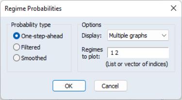

To display the estimated regime probabilities select View/Regime Results/Regime Probabilities...
EViews offers a choice between the One-step-ahead, Filtered, and Smoothed probabilities. For simple switching models without AR terms, the filtered and smoothed results are the same. In addition, you may display the results in Multiple graphs, in a Single graph, or in Sheet form.
For graphical output you may also select which regimes to plot by entering the corresponding indices in the Regimes to plot edit field. While the default is to show the probabilities for all regimes, you may use the edit field to remove redundant probabilities or to focus on a specific regime of interest.

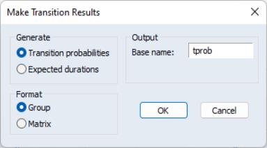

To save transition probability or expected duration results in the workfile click on Proc/Make Regime Results/Make Transition Results...
In addition to prompting you to choose between saving the Transition probabilities or the Expected durations, you must select an output format. By default, EViews will save the results in a group of series in the workfile. The series names will be formed using the base name specified in the edit field, as in “TPROB12”, “TPROB22”, etc. for transitions, and “TPROB1”, “TPROB2”, etc. for expected durations.
You may instead elect to save the results in a matrix. In this case, EViews will prompt you for the name of the matrix and for an observation at which to evaluate the transition matrix or expected duration. By default, the dialog will be filled with the first observation in the estimation sample.

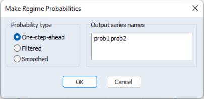

To save the regime probabilities, select Proc/Make Regime Results/Make Regime Probabilities Group...
Select the type of probability you wish to compute (One-step-ahead, Filtered, or Smoothed), and enter the names of series to hold the results, one for each probability you wish to retain.
