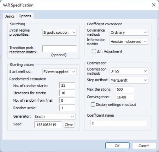

Clicking on the Options tab displays options for modifying features of the switching specification and for controlling various aspects of the computation.

The Switching options section may be used to specify the initial state probabilities and any restrictions to the regime probability vector or transition matrix.
Recall that evaluation of the likelihood in Markov switching and SSAR models requires presample values for the filtered probabilities ( “Initial Probabilities”). The Initial regime probabilities dropdown lets you choose the method of initializing these values (Ergodic solution (default), Estimated, Uniform, User-specified). If you select User-specified, you will be prompted for the name of an -element vector in the workfile that contains the initial probabilities.
The Probability restriction vector/Transition restriction matrix edit field allows you to specify restrictions on the regime probabilities. Markov switching models, in particular, will sometime require restrictions on transition matrix probabilities. For example, we may have if it is impossible to transition directly from state to state . Similarly, if state is an absorbing state, then and for .
To specify restrictions, you should enter the name of an -element vector in the workfile (for a SSAR model), or an matrix in the workfile (for Markov switching) in the edit field. The vector or matrix should contain valid probability values for elements that are restricted and NAs for elements that are to be estimated. For example, in a three regime Markov switching model where state 3 is an absorbing state, you would have

The Iteration control section contains the standard fields for setting the maximum number of iterations and convergence tolerance. By default, EViews will use the estimation settings from your global options.You may select the Display settings checkbox to display starting values and other estimation settings in the top section of your estimation output.
You may use the Starting values section to control the setting of initial parameter estimates. Switching regression models often have local roots and may be difficult to estimate so EViews offers a range of tools for choosing starting values.
Start Method
The Start method dropdown allows you to specify a basic method for choosing starting values (EViews Supplied, .8 x EViews Supplied, .5 x EViews Supplied, .3 x EViews Supplied, Zero, User-Supplied).
The EViews supplied methods employ simple least squares coefficient estimates or the specified fraction of those estimates. AR coefficients are arbitrarily initialized to zero.
The Zero and User-Supplied methods are self-explanatory, with the latter taken from the default coefficient vector specified in the dialog (typically the coefficient vector C).
Randomized Estimates
The first two edit fields under Randomized estimates allow you to choose random starting values based on the those specified in the Start method dropdown.
• EViews will randomly choose the number of random starts as specified in No. of random starts and for each random start perform the number of iterations as specified in Iterations for starts. The coefficients with the highest likelihood value will be chosen as the starting values.
For non user-supplied starting values, EViews will, by default, generate 25 sets of random starting values and refine each with 10 iterations before choosing the best set as the starting values. By default, there is no randomization of user-supplied values.
In addition to randomizing based on the initial values, you may randomize based on the final coefficient estimates. The No. of random from final edit field determines the number of random coefficients to try following estimation.
• The random starting values are chosen by taking the best estimated values to date and adding random normals with scale given by the Random scale fraction of the final coefficient standard deviations. The estimates with the highest likelihood become the final estimates.
By default, EViews does not perform randomization based on the final coefficient estimates.
For both initial and final randomization, the random starting values are chosen by taking the base values and adding random normals with scale given by the Random scale fraction of the root of the estimated coefficient variances (or the scale fraction itself if the variances are not available). The random values will be generated using the Generator specified in the dropdown and the random Seed specified in the edit field. If a random seed is not specified, EViews will obtain one from a single draw from the generator.

EViews estimates the parameters of the likelihood using the Broyden, Fletcher, Goldfarb and Shanno (BFGS) method. By default, the coefficient covariance is computed using a non d.f. corrected inverse of the negative of the observed Hessian.
You may use the Covariance method dropdown to instruct EViews to use the Hessian, the outer product of the gradient (OPG) method, or a Huber-White robust covariance that forms a sandwich using the Hessian and gradients.
The d.f. Adjustment checkbox may be used to apply a d.f. correction.
Optimization Options
You may use the Optimization method dropdown menu to select a different method.
By default, EViews uses BFGS with Marquardt steps to obtain parameter estimates. You may use the Optimization method dropdown to choose between BFGS, OPG - BHHH, or Newton-Raphson. The Step method dropdown offers the choice of Marquardt, Dogleg, and Line search.
See “Optimization Method” for discussion.
The remainder of the section allows you to specify a convergence criterion and the maximum number of iterations, and to instruct EViews to display starting value and other optimization information in the output.
