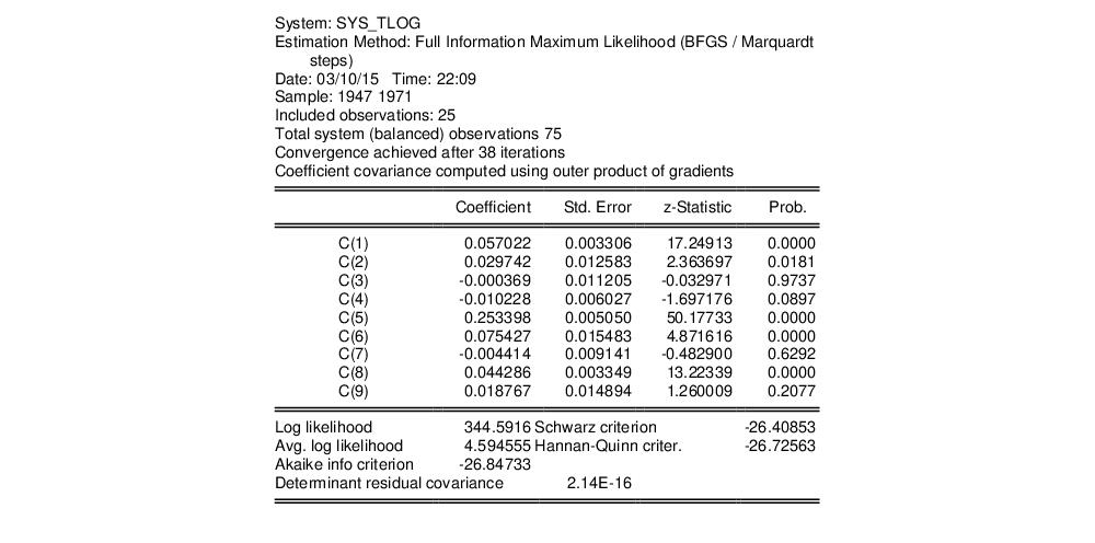

To estimate this model using FIML, click Estimate and choose Full Information Maximum Likelihood. We will leave the Residual covariance combo at the default setting of Unrestricted to allow for estimation of an unrestricted covariance matrix. Click on OK to estimate the equation.
The top part of the equation describes the estimation specification, and provides coefficient and standard error estimates, t-statistics, p-values, and summary statistics:
The log likelihood value reported at the bottom of the first part of the table may be used to construct likelihood ratio tests.

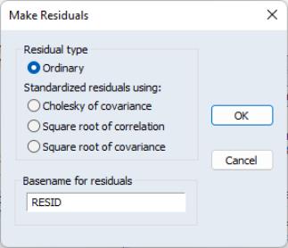

Since maximum likelihood assumes the errors are multivariate normal, we may wish to test whether the residuals are normally distributed. Click Proc/Make Residuals to display the residuals dialog. You may choose to save the ordinary or standardized residuals. If you choose the latter, you can elect to standardize the residuals using the Cholesky factor of the (conditional) covariance, the square root of the (conditional) correlation matrix, or the square root of the (conditional) covariance matrix. You must enter a basename for saving the residuals. The residuals will be named using the next available names in the workfile, in this case “RESID01”, “RESID02”, ...., if those names are not already used.
In this example, we elect to produce ordinary residuals. EViews opens an untitled group window containing the residuals of each equation in the system. To compute descriptive statistics for each residual in the group, select View/Descriptive Stats/Common Sample from the group window toolbar.

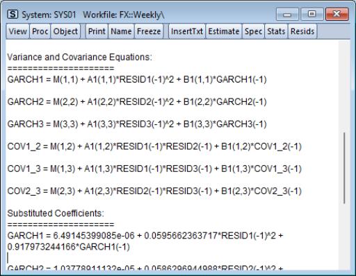

A single equation representation of the variance-covariance equation may be viewed by clicking on View/Representations and scrolling down to the Variance and Covariance Equations section.
The GARCH equations are the conditional variance equations while the COV equations are the conditional covariance equations. For example GARCH1 is the conditional variance of Japanese yen. COV1_2 is the conditional covariance between the Japanese Yen and the Swiss Franc.

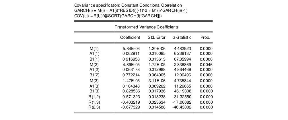

Another possibility is to model the covariance matrix using the CCC specification, which imposes a constant correlation over time. We proceed by creating a new system with specification identical to the one above. We'll select Constant Conditional Correlation this time as the Model type for estimation and leave the remaining settings as they are. The basic results:
Note that this specification has only 12 free parameters in the variance equation, as compared with 18 in the previous model. The extended variance section represents the variance equation as,
GARCH(i) = M(i) + A1(i)*RESID(i)(-1)^2 + B1(i)*GARCH(i)(-1)
while the model for the covariance equation is:
COV(i,j) = R(i,j)*@SQRT(GARCH(i)*GARCH(j))
The lower portion of the output shows that the correlations, R(1, 2), R(1, 3), and R(2, 3) are 0.5713, -0.4032, and -0.6773, respectively:
