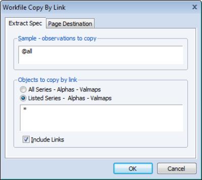

To copy all or part of the data in a workfile by creating links, you should select Proc/“Copy Extract from Current Page”/By Link to New Page.... EViews will open the Workfile Copy By Link dialog in which you will specify the data to be copied.
There are two principal ways that you can specify a subset of the data to be copied: you may specify a subsample of observations in the workfile or you may specify a subset of the series objects.
EViews will copy all of the observations in the sample specified in the edit box labeled Sample - observations to copy. To specify a subsample of observations, you should replace the default “@ALL” with a valid EViews sample.
You may elect to copy all series, alphas, and valmaps, or you may select the Listed Series - Alphas - Valmaps radio button and enter a list of the series to be copied, with wildcards, if desired.
If the Include Links checkbox is selected, EViews will copy series and alpha links along with ordinary series and alphas. If you uncheck Include Links, EViews will drop all link objects from the copy list.

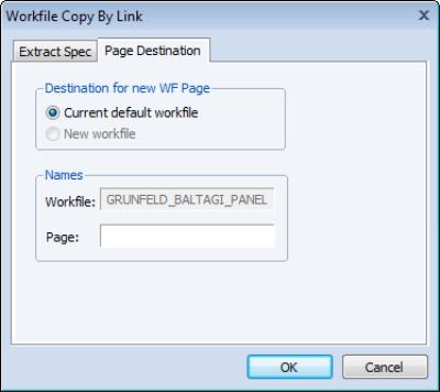

The copy by link procedure will create the links in a new page in the existing workfile. By default, the page will be given a name based on the page structure (e.g., “Annual”, or “Daily5”). You may provide a name for this destination page by clicking on the Page Destination tab and enter the desired name. If a page with that name already exists in the workfile, EViews will create a new page using the next available name. Note that since we are copying by link, you may not create a page in a different workfile.

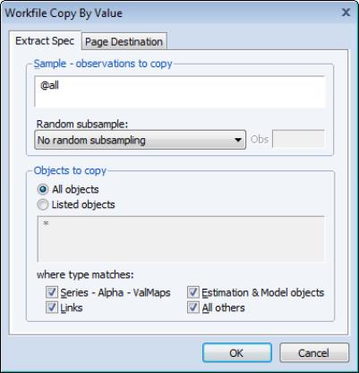

To copy all or part of the workfile by value, you should select Proc/“Copy/Extract from Current Page”/By Value to New Page or Workfile.... EViews will open the Workfile Copy By Value dialog.
You should first specify an EViews sample describing the observations to be copied. By default, EViews will use the sample “@ALL”.
Next, you should use the dropdown menu to select a Random subsample method. By default, all of the observations in the sample will be used (No random subsampling), but you may choose to extract a random sample in one of three ways:
• You may extract a subsample with a fixed number of observations (Fixed subsample size - number of observations). If the specified subsample size is larger than the number of observations, the entire sample is used.
• You may select a subsample with a fixed size, where the number of observations is specified as a percent of the total number of observations (Fixed subsample size - % of observations).
• You may take a simple random sample in which every observation has a fixed probability of being selected (Random subsample size - % applied to each obs). As the label suggests, the number of observations in the resulting subsample is itself random.
In the remainder of the dialog page you should specify the objects to be copied. There are two parts to the object specification: a list of object names, and a set of modifiers for object types.
By default, the All objects radio button is selected so that the list of object names provided to EViews will include every object in the source workfile. You may instead provide an explicit list by clicking on the Listed objects radio button and entering the names of objects (using wildcards if appropriate).
The type matching checkboxes (Series - Alphas - Valmaps, Links, Estimation & Model Objects, All others) may be used to restrict the object list on the basis of broad classifications for type; an object will be copied only if it is in the list of object names provided in the edit box, and if its type matches a classification that you elect to copy. If, for example, you wish to remove all objects that are not series objects or valmaps from your list, you should uncheck the Estimation & Model objects and the All others checkboxes.
Lastly, you may optionally provide a destination workfile page. By default, EViews will copy the data to a new workfile in a page named after the workfile page structure (e.g., “Quarterly,” “Monthly”). You may provide an alternative destination by clicking on the Page Destination tab in the dialog, and entering the desired destination workfile and/or page.
