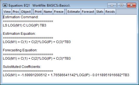

• Representations. Displays the equation in three basic forms: EViews command form showing the command associated with the equation, as an algebraic equation with symbolic coefficients, and as an equation with a text representation of the estimated values of the coefficients.
You can cut-and-paste from the representations view into any application that supports the Windows clipboard.

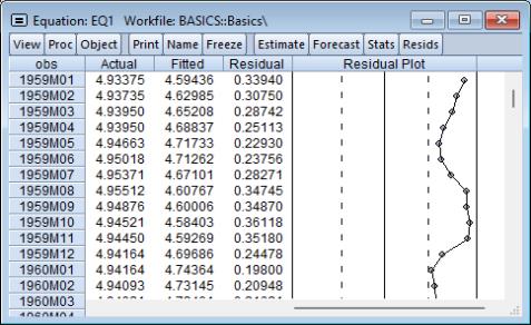

• Actual, Fitted, Residual. These views display the actual and fitted values of the dependent variable and the residuals from the regression in tabular and graphical form. Actual, Fitted, Residual Table displays these values in table form.
Note that the actual value is always the sum of the fitted value and the residual. Actual, Fitted, Residual Graph displays a standard EViews graph of the actual values, fitted values, and residuals, along with dotted lines showing at plus and minus one estimated standard error. Residual Graph plots only the residuals, while the Standardized Residual Graph plots the residuals divided by the estimated residual standard deviation.
