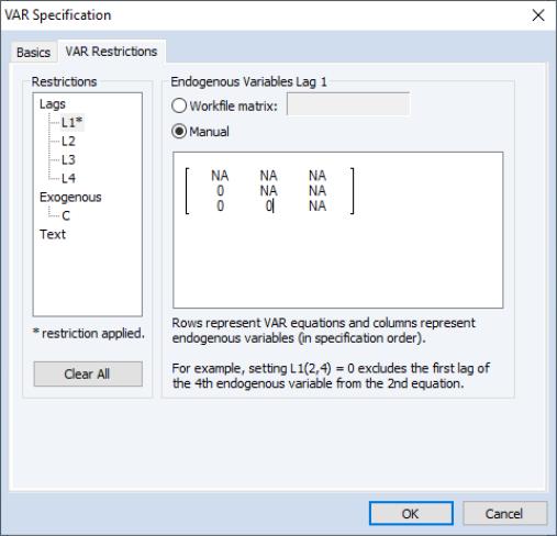

The Restrictions section on the left should be used to select the VAR elements that you wish to restrict. You may click on the entries for the lag matrices (L1, L2, L3, L4) and the vectors of coefficients associated with each exogenous variable (C) to select an element to restrict. The right side of the dialog will change to show the current settings for the selected element.
• If the Manual method is selected, you will place restrictions on the selection by editing its matrix representation in the dialog (rows of the matrix represent VAR equations while columns represent the endogenous variable). The ordering of the matrix elements follows the order of the endogenous variables in the original specification. Elements of the matrix or vector that are NA will be estimated while the remaining elements will be restricted to the specified value.
Here, we have selected the matrix for the first lag of the endogenous variables (L1) and set two elements to zero so that the lag of the first endogenous variable has no effect on the second and third endogenous variables.

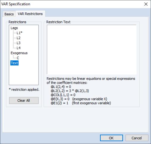

In settings where restricting a large number individual elements is inconvenient, or where you wish to impose restrictions across lag or exogenous variable coefficients, you may find it more convenient to specify restrictions using text expressions. In this case, click on the Text node of the Restrictions tree to display the Restriction Text edit field.
Text expressions allow you to use a function-like syntax to employ text to specify restrictions on one or more matrix elements. The text restrictions will use the following “@” keywords that you may use to refer to individual coefficient matrix elements,

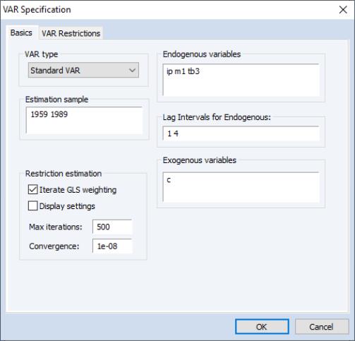

When restrictions have been applied, the Basics tab of the dialog will change to offer additional options. In the newly displayed Restriction estimation section in the bottom left o the dialog, you will be prompted to specify the method of estimating your restricted coefficients:
In you do not select the Iterate GLS weighting option, EViews will estimate the parameters of the model using one-step GLS estimation. If you do select Iterate GLS weighting you will be prompted to specify the iteration and convergence properties of the estimation. To estimate with OLS, you may select Iterate GLS weighting and specify a Max Iterations of 0.

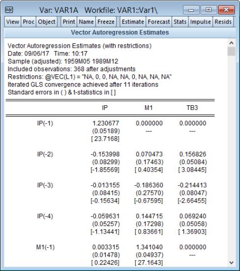

Following estimation, EViews will display the results of restricted estimation. For the most part, the results are as described in “Estimation Output”, but there are some differences of note.
First, the top of the estimation output shows that the VAR estimates were estimated with restrictions, and provides a text description of the restrictions. Here we see that in our illustration, we have placed zero restrictions on the first lag coefficients for IP in the M1 equation, and for IP and M1 in the TB3 equation.
Just below the restrictions specification, EViews displays information about the restricted estimation method. Here, we see that EViews estimated the VAR using iterated GLS and that the coefficients and GLS weight matrix converged after 11 iterations.
The coefficients display shows the full set of VAR coefficient estimates with restrictions imposed as appropriate. In cases, where the estimated standard error of the coefficient is zero, the display will show “---” and the t-statistic is suppressed.

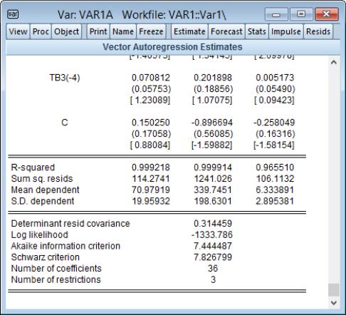

As for unrestricted VARs, the bottom of the output show additional information on the individual equations and summary statistics for the VAR as a whole:
As before, there are standard OLS regression summary statistics at the bottom of the column for the corresponding equation. Since linearly restricted VAR regression is not computed on an equation by equation basis, EViews only displays a subset of the equation specific statistics that are available for unrestricted VAR estimation.
The remaining output consists of summary statistics for the VAR system as a whole. These statistics include the determinant of the residual covariance (non-d.f. corrected), log-likelihood and associated information criteria, the number of coefficients, and number of restrictions.
