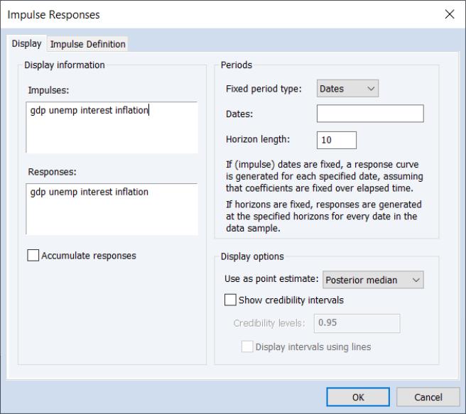

To generate BTVCVAR impulse responses via dialog, go to View/Impulse Response... or click on the Impulse button in the VAR toolbar. This will open the BTVCVAR version of the Impulse Responses dialog:
The dialog has two tabs: a Display tab where you will describe the default display settings, and an Impulse Definition tab where you will describe how you wish the impulses to be constructed.
Display Settings
There are three sections in the Display tab.

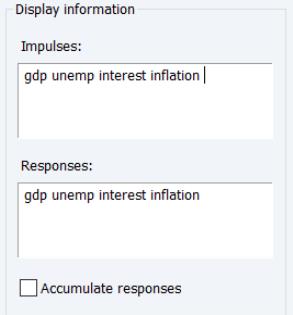

The Display information section is nearly identical to that for a standard VAR IRF. Here, you will specify the impulses and responses you wish to examine and determine whether to produce accumulated responses:
Note that the Horizon length edit field has been moved out of this section to accommodate cross-section fixed horizon computation.

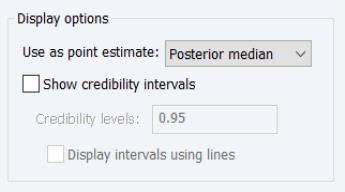

The Display options offer settings for which coefficient values to use when compute the impulse responses, whether to show credibility intervals in tables and graphs, and if so, how they should be computed and displayed in graphs:
• The Use as point estimates drop down should be used to choose between using the Posterior median or the Posterior mean values.
• The Show credibility intervals checkbox determines whether to show the intervals in tables and graphs. If you elect to show the intervals, you will be prompted to provide one or more Credibility values in the edit field, and will be shown a checkbox for whether to Display intervals using lines in graphs.

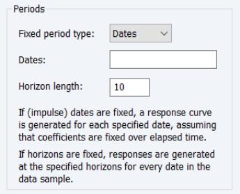

The Periods section controls whether you will produce IRs that are for fixed periods (dates) or for fixed horizons, and at which values to perform the computation.
• If you set the Fixed period type dropdown to Dates, EViews will prompt you to enter one or more Dates as which to compute impulse responses, and the Horizon length up to which those responses should be computed:
Only valid dates in the estimation sample are permitted.

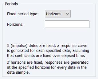

• If you set the Fixed period type dropdown to Horizons, EViews will prompt you to enter one or more Horizons at which to compute the IRs:
The specified horizons must be positive integers. Note that IRs are computed for every date in the data sample.

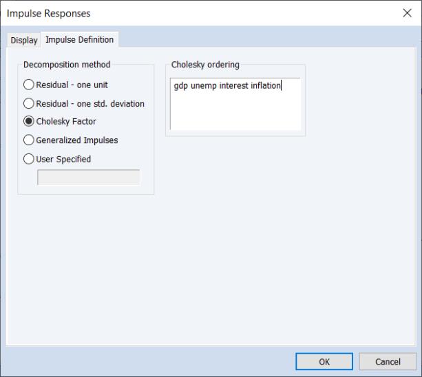

Impulse Definition Settings
The Impulse Definition tab specifies the method used to produce impulses.
See “Impulse Definitions” for discussion.

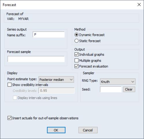

To generate forecasts, go to Proc/Forecast... or click on the Forecast button in the VAR toolbar.
If Dynamic forecast is selected, forecasts are generated from a standard, time-invariant VAR with coefficients taken from the first date in the forecast sample. If the forecast sample starts after the data sample, then coefficients are taken from the last date in the data sample.
If Static forecast is selected, forecasts are generated from a time-varying VAR until the end of the data sample. Forecasts after the data sample are generated from a standard VAR with coefficients taken from the end of the data sample.
Forecast display options are identical to those used in estimation.
