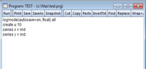

To create a new program, click File/New/Program. You will see a standard text editing window where you can type in the lines of the program. You may also open the program window by typing program in the command window, followed by an optional program name. For example
program firstprg
opens a program window named “FIRSTPRG”. Program names should follow standard EViews rules for file names.

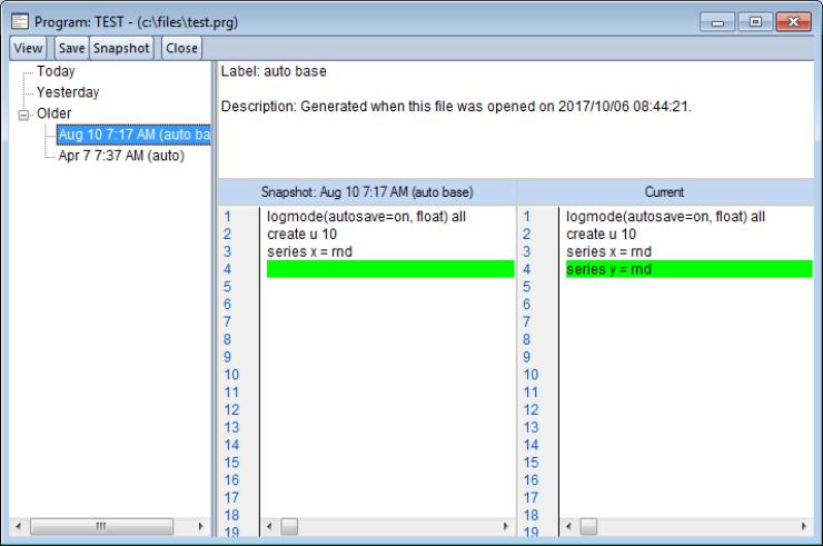

Snapshots for Programs

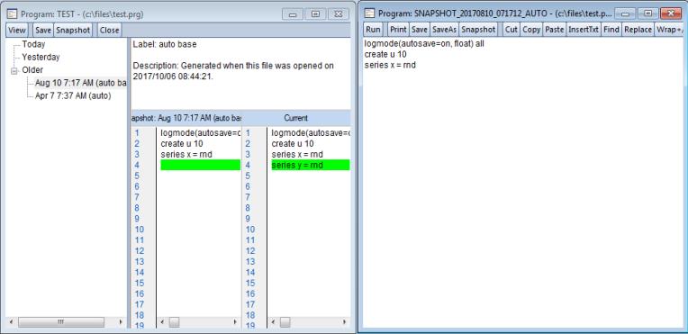

Managing snapshots for an EViews program is similar to workfiles ( “Snapshot Backups”). The program window has a Snapshot button to perform a manual snapshot.
Viewing Snapshots for Programs
To view available snapshots for a program, right-click in the program window and select Snapshots…
Clicking on a previous snapshot will display a text compare view that highlights any differences between the two versions.
You can also right-click any snapshot and select Open… (or simply double-click the node) to open the snapshot in its own program window.

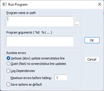

To run a program from a dialog, click on the Run button on the program window. The Run dialog opens.
The default run options are taken from the global settings ( “Programs”), but may be overridden on a one-time basis using the dialog settings or command options. For purposes of discussion, we will assume that the global options are set to their out-of-the-box values.
The Program name or path edit field will show the name and in some cases, path, of the program you are running. You may enter a file specification to instruct EViews to look for a particular program.
The Program arguments edit field is used to define special string variables that will be passed to your program when it is running. See “Program Arguments” for details.
The Runtime errors section allows you to modify the behavior of the program when it encounters an error. By default, when EViews encounters an error, it will immediately terminate the program and display a message. If you enter a number into the Maximum errors before halting field, EViews will, if possible, continue to execute the program until the maximum number of errors is reached. If it encounters a serious error that makes it impossible to continue, EViews will halt the program even if the maximum number of errors is not reached. See “Execution Errors”.
If the Compatibility section checkbox labeled Version 4 compatible variable substitution and program boolean comparisons is selected, EViews will use the variable substitution behavior found in EViews 4 and earlier. To support the use of alpha series, EViews 5 and subsequent versions altered the way that % substitution variables are evaluated in expressions. To return to EViews 4 compatible rules for substitution, you may either use this checkbox or include a “MODE VER4” statement in your program. See “Version 4 Compatibility Notes” and “Program Modes” for additional discussion.
Lastly, you may select the Save options as default checkbox to update your global options with the specified settings. Alternately, you may change the global options from the Options/General Options.../Programs/General dialog.

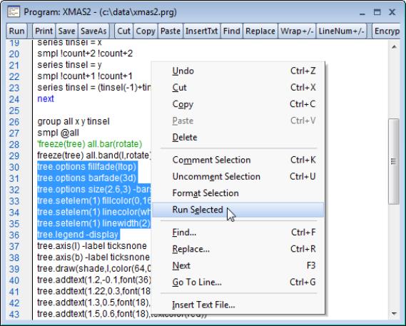

You may choose to only run part of your program by highlight the lines you wish to run, then right-clicking and selecting Run Selected. EViews will then execute only the selected line of code as a new program.
You should note that there are potential pitfalls when using Run Selected. The first is that no arguments or options can be passed into the selected lines of code. If the selected lines rely on program arguments or options, they will fail to execute properly. Similarly, any program variables ( “Program Variables”) declared outside of the selected lines may not be initialized properly when the selected lines are run. Finally, any subroutines declared outside of the selected lines of code cannot be called, since they do not exist in the selected code.

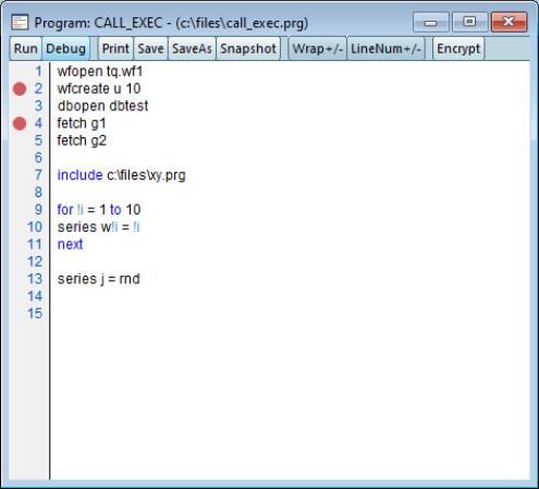

Setting and Clearing Breakpoints
Open the EViews program file and set the breakpoint by clicking to the left of the desired line. A red dot will appear:
Clicking on a red dot clears that breakpoint.
Starting a Debugging Session
To begin debugging the program, click the Debug button in the toolbar and enter any program arguments, choose whether to Log dependencies, and if desired change the Maximum errors before halting. Click on OK.
EViews will start program execution and open the debugging pane. There are three tabs in the pane: Breakpoints, Watch, and Callstack.

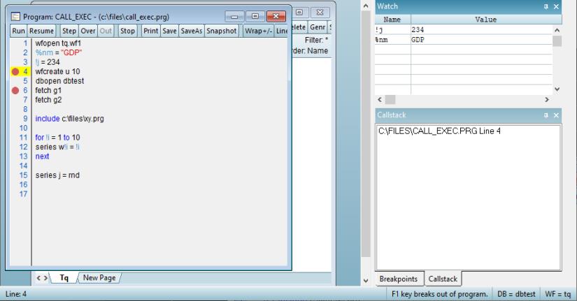

Stopping at a Breakpoint
When the program reaches an active breakpoint, the execution will pause at the red dot, now highlighted in yellow:
At this point you can look at the Breakpoints, Callstack, or Watch windows for more information.
• Breakpoints shows all defined breakpoints. Toggling the checkbox next to a breakpoint name inactivates or reactivates it.
• Callstack displays the current line of the active files and subroutines of the program.
• Watch presents the values of program and replacement variables.
Additionally, you may open EViews objects such as series or equations to examine their current states.

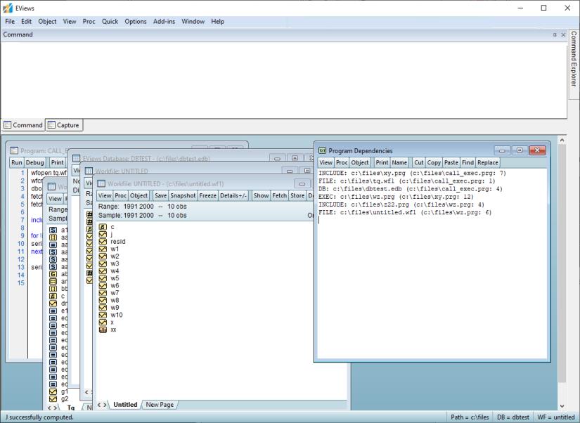

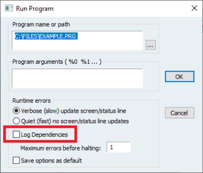

EViews 14 has a new feature to automatically log a program’s external dependencies: files (as workfiles, Excel files, CSV files, etc), databases, and other programs (as includes and execs). To use it, check the Log Dependencies checkbox in the Run Program dialog:
A new Program Dependencies window will appear showing the type, filename, and path of all the external dependencies detected during the run.
The above image shows the dependence on the external program files “xy.prg,” “wz.prg,” and “z22.prg,” the workfiles “tq.wf1” and “untitled.wf1,” and the database “dbtest.edb,” along with the line numbers producing these dependencies.
