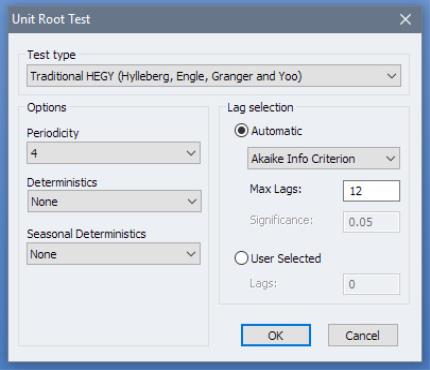

To begin, double click on a series name to open the series window. From there, select View/Unit Root Tests/Seasonal Unit Root Tests...
You may choose between:
• Traditional Hylleberg, Engle, Granger, and Yoo (HEGY) test
• HEGY Likelihood Ratio test
• Canova-Hansen test
• Variance ratio test

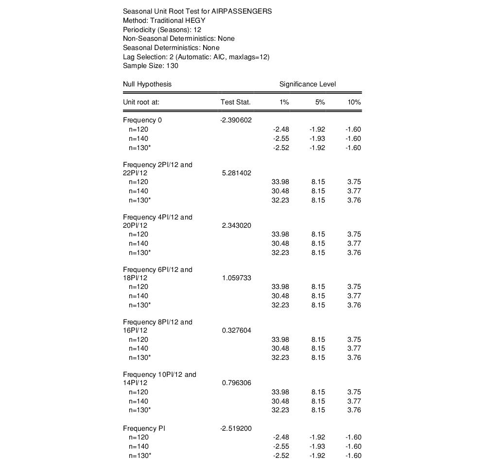

For example, results for a traditional HEGY test are of the form:
