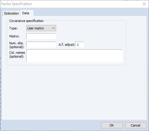

User-matrix Specification
User-matrix in the Type dropdown, the dialog changes, prompting you for the name of the matrix and optional information for the number of observations, the degrees-of-freedom adjustment, and column names.
• You should specify the name of an EViews matrix object containing the measure of association to be fit. The matrix should be square and symmetric, though it need not be a sym matrix object.
• You may enter a scalar value for the number of observations, or a matrix containing the pairwise numbers of observations. A number of results will not be computed if a number of observations is not provided. If the pairwise number of observations is not constant, EViews will use the minimum number of observations when computing statistics.
• Column names may be provided for labeling results. If not provided, variables will be labeled “V1”, “V2”, etc. You need not provide names for all columns; the generic names will be replaced with the specified names in the order they are provided.

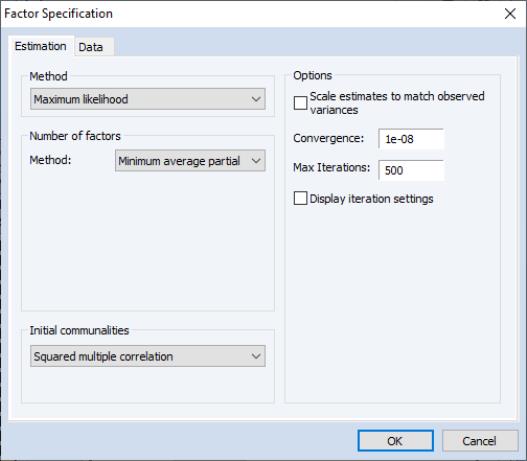

The main estimation settings are displayed when you click on the Estimation tab of the Factor Specification dialog. There are four sections in the dialog allowing you to control the method, number of factors, initial communalities, and other options. We describe each in turn.
Method
In the Method dropdown menu, you should select your estimation method. EViews supports estimation using Maximum likelihood, Generalized least squares, Unweighted least squares, Principal factors, Iterated principal factors, and Partitioned (PACE) methods.
Depending on the method, different settings may appear in the Options section to the right.
Number of Factors
EViews supports a variety of methods for selecting the number of factors. By default, EViews uses Velicer’s (1976) minimum average partial method (MAP). Simulation evidence suggests that MAP (along with parallel analysis) is more accurate than more commonly used methods such as Kaiser-Guttman (Zwick and Velicer, 1986). See “Number of Factors” for a brief summary of the various methods.

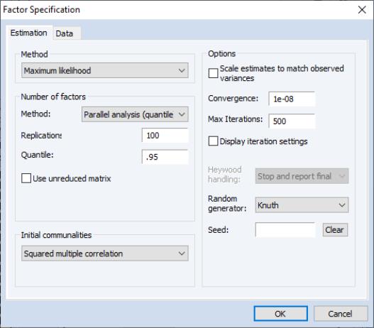

• If you select either Parallel analysis (mean) or Parallel analysis (quantile) from the dropdown menu, the dialog page will change to provide you with a number of additional options.
In the Number of factor sections, EViews will prompt you for the number of simulations to run, and, where appropriate, the quantile of the empirical distribution to use for comparison.
By default, EViews compares the eigenvalues of the reduced matrix against simulated eigenvalues. This approach is in the spirit of Humphreys and Ilgen (1969), who use the SMC reduced matrix. If you wish to use the eigenvalues of the original (unreduced) matrix, simply check Use unreduced matrix.
The Options section of the page provides options for the random number generator and the random seed. While the Random generator dropdown should be self-explanatory, the Seed field requires some discussion.
By default, the first time that you estimate a given factor model, the Seed edit field will be blank; you may provide your own integer value, if desired. If an initial seed is not provided, EViews will randomly select a seed value at estimation time. The value of this initial seed will be saved with the factor object so that by default, subsequent estimation will employ the same seed. If you wish to use a different value, simply enter a new value in the Seed edit field or press the Clear button to have EViews draw a new random seed value.
