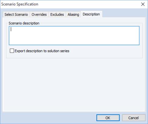

The Description tab may be used to store notes describing the purpose of each scenario and, if desired, to include the description in the solution series. If the Export description to solution series check box is checked, any series that are generated during a solve under the scenario will have the scenario’s description added to their own description attribute.

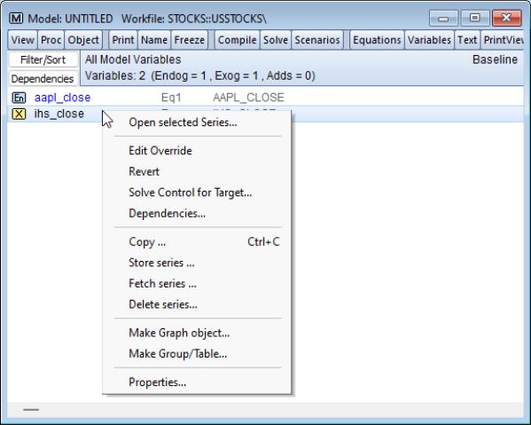

The Edit override right button menu item, available from the variables view of a model, lets you quickly exclude, override and edit endogenous and exogenous variables for the current scenario.
To simultaneously create an override for an exogenous variable and open it for editing, first select View/Variables to display the model in variables view, then select Edit override from the right mouse button menu. EViews will ask you to confirm that you wish to override the variable, and will then open an untitled group containing the original series and the newly created override series for the current scenario. Again the group is opened in compare mode ( “Group Comparison Tools”) to facilitate easy editing of the new series.
Edit override may also be used for endogenous variables, in which case EViews will simultaneously exclude and override the variable for the current scenario.
You may quickly revert an overriden variable back to its original non-overriden values by using the Revert right button menu item.

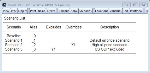

Scenario List
The scenario list view of a model (available from View/Scenario View) displays a list of each of the model’s scenarios, along with their alias, overrides or excludes, and descriptions:
