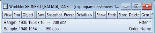

For dated workfiles, you may specify panel samples using date pairs to define the earliest and latest dates to be included. For example, in our dated panel example from above, if we issue the sample statement:
smpl 1940 1954
EViews will exclude all observations that are dated from 1935 through 1939. We see that the new sample has eliminated observations for those dates from each cross-section.

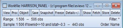

For example, the sample statement,
smpl if townid<>10 and lstat >-.3
is equivalent to either of the commands,
smpl @all if townid<>10 and lstat >-.3
smpl 1 506 if townid<>10 and lstat >-.3
and selects all observations with TOWNID values not equal to 10, and LSTAT values greater than -0.3.

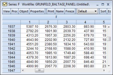

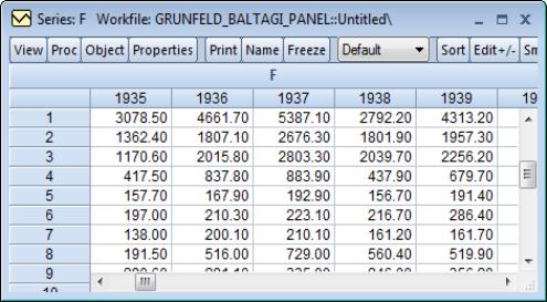

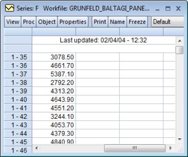

When looking at the spreadsheet view of a series in a panel workfile the default view will be to show the “stacked” form of the series - each cross-section’s data will be below the previous cross-section’s data.
You may change this by clicking on the Wide +/- button (you will almost certainly need to widen the window to see the button as it is far to the right of the more commonly used buttons). The first time you click the button, EViews will change the display of the series such that each row of the spreadsheet contains data for a specific date, and each column contains data for a cross-section.
Clicking the Wide +/- button a second time transposes this so cross-sections are now shown per row, and dates per column.
A third click of the button takes the view back to the original stacked form.

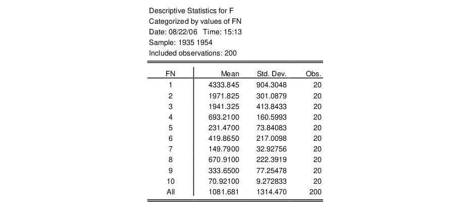

Viewing Summaries

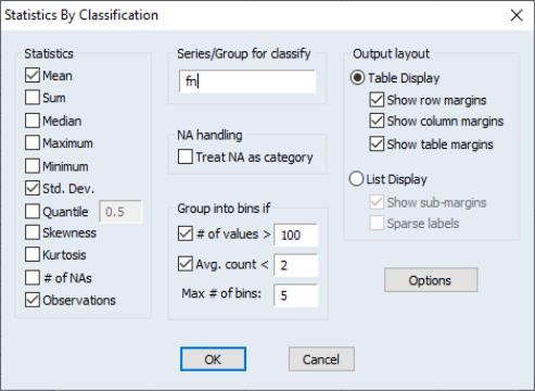

The easiest way to compute by-group statistics is to use the standard by-group statistics view of a series. Simply open the series window for the series of interest and select View/Descriptive Statistics & Tests/Stats by Classification... to open the Statistics by Classification dialog.
First, you should enter the classifier series in the Series/Group to classify edit field. Here, we use FN, so that EViews will compute means, standard deviations, and number of observations for each cross-section in the panel workfile. Note that we have unchecked the Group into bins options so that EViews will not combine periods. The result of this computation for the series F is given by:
Alternately, to compute statistics for each period in the panel, you should enter “DATEID” instead of “FN” as the classifier series.

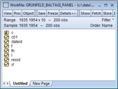

Since we will be computing both by-firm and by-period descriptive statistics, the first step is to create workfile pages to hold the results from our two sets of calculations. The firm page will contain observations corresponding to the unique values of the firm identifier found in the panel page; the annual page will contain observations corresponding to the observed years.

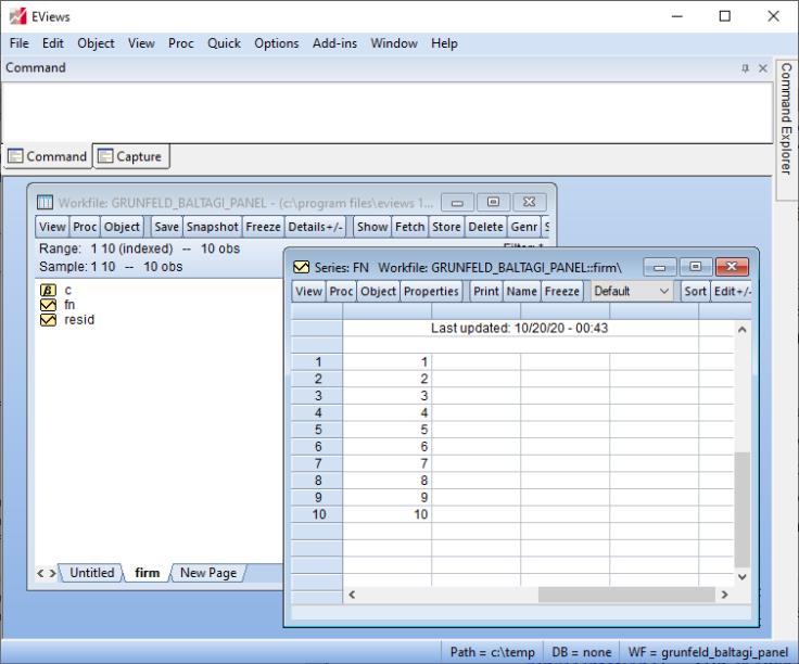

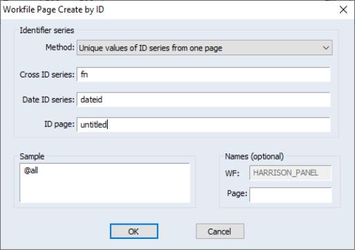

To create a page for the firm data, click on the New Page tab in the workfile window, and select Specify by Identifier series.... EViews opens the Workfile Page Create by ID dialog, with the identifiers pre-filled with the series used in the panel workfile structure—the Date series field contains the name of the series used to identify dates in the panel, while the Cross-section ID series field contains the name of the series used to identify firms.

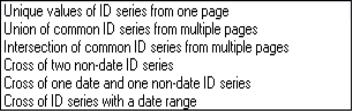

The default Method is set to Unique values of ID series from one page, which instructs EViews to simply look at the unique values of the ID series in the specified ID page. Alternately, you may provide multiple pages and take the union or intersection of IDs (Union of common ID series from multiple pages and Intersection of common ID series from multiple pages). You may also elect to create observations associated with the crosses of values for multiple series; the different choices permit you to treat date and non-date series asymmetrically when forming these categories (Cross of two non-date ID series, Cross of one date and one non-date ID series, Cross of ID series with a date range). If you select the latter, the dialog will change, prompting you to specify a frequency, start date and end date.
To create a new workfile page using only the values in the FN series, you should delete the Date series specification “DATEID” from the dialog. Next, provide a name for the new page by entering “firm” in the Page edit field. Now click on OK.
EViews will examine the FN series to find its unique values, and will create and structure a workfile page to hold those values.

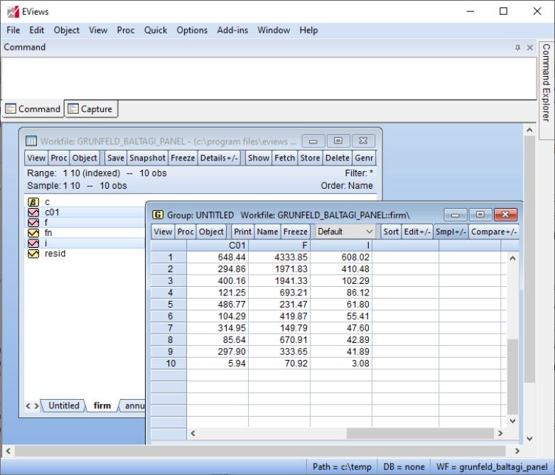

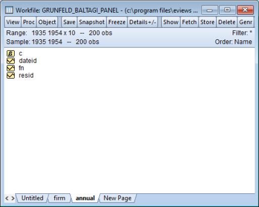

Here, we see the newly created FIRM page and newly created FN series containing the unique values from FN in the other page. Note that the new page is structured as an Undated with ID series page, using the new FN series.
Repeating this process using the DATEID series will create an annual page. First click on the original panel page to make it active, then select New Page/Specify by Identifier series... to bring up the previous dialog. Delete the Cross-section ID series specification “FN” from the dialog, provide a name for the new page by entering “annual” in the Page edit field, and click on OK. EViews creates the third page, a regular frequency annual page dated 1935 to 1954.

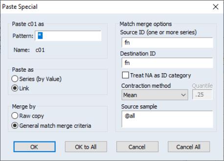

To create links containing the desired summaries, first click on the original panel page tab to make it active, select one or more series of interest, then right mouse click and select Copy. Next, click on either the firm or the annual page, right mouse click, and select Paste Special.... Alternately, right-click to select the series then drag the selected series onto the tab for the destination page. EViews will open the Link Dialog, prompting you to specify a method for summarizing the data.
Suppose, for example, that you select the C01, F, and I series from the panel page and then Paste Special... in the firm page. In this case, EViews analyzes the two pages, and determines that most likely, we wish to match merge the contracted data from the first page into the second page. Accordingly, EViews sets the Merge by setting to General match merge criteria, and prefills the Source ID and Destination ID series with two FN cross-section ID series. The default Contraction method is set to compute the mean values of the series for each value of the ID.
You may provide a different pattern to be used in naming the link series, a contraction method, and a sample over which the contraction should be calculated. Here, we create new series with the same names as the originals, computing means over the entire sample in the panel page. Click on OK to All to link all three series into the firm page, yielding:
You may compute other summary statistics by repeating the copy-and-paste-special procedure using alternate contraction methods. For example, selecting the Standard Deviation contraction computes the standard deviation for each cross-section and specified series and uses the linking to merge the results into the firm page. Saving them using the pattern “*SD” will create links named “C01SD”, “FSD”, and “ISD”.
